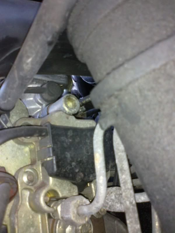

I still cant believe how much trouble i'm having finding the fuel screw ha. I tried last weekend.
I removed the black clip and unscrewed the top bolt (obscured by the wire in the photo) it wouldnt budge at all.
Also where did you put the induction kit on your previous photo? i been looking into doing something like this myself but haven't found a good point to put the intake

Dosen't look like you've moved the immob plate? if you havent then all I'm going to say is have funNollingtonHards wrote:I still cant believe how much trouble i'm having finding the fuel screw ha. I tried last weekend.
