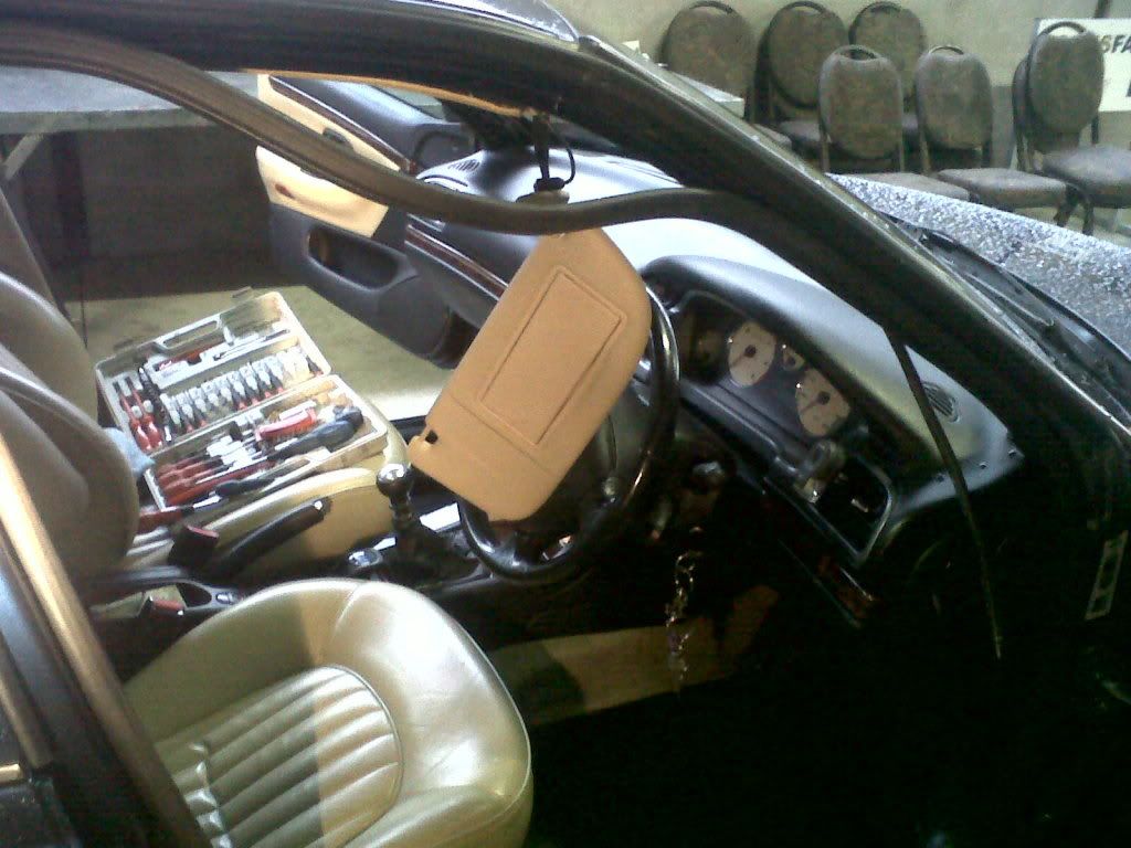

So i followed that article in the knowledge base about this and i checked the a pillar pipes, and the knurled ends, all were clear and yet the leaks still occured, mainly on the drivers side, so i took out the front sun visor, grab handle and courtesy light to get a better look under the headlining:

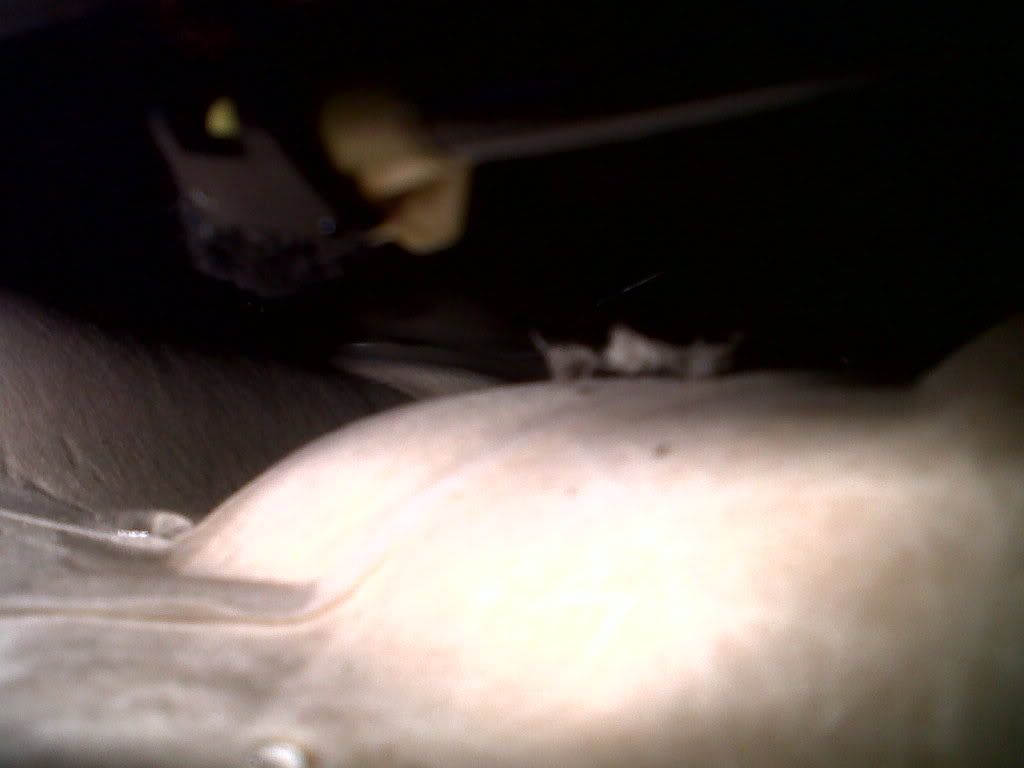

this is what i seen (apologies for the blackberrys lack of quality pics):
its blurry but the yellow dot at the top is light getting in, and this means a hole for water to get down onto the headlining and where it was getting into the car was through the wee holes in the rivets along the sunroof slider there at the front, so all i did was pumped a bit of silicone into them on each side 6 rivets in total 3 each side. Waited an hour for it to dry and hey presto problem solved and it cost nothing to solve.

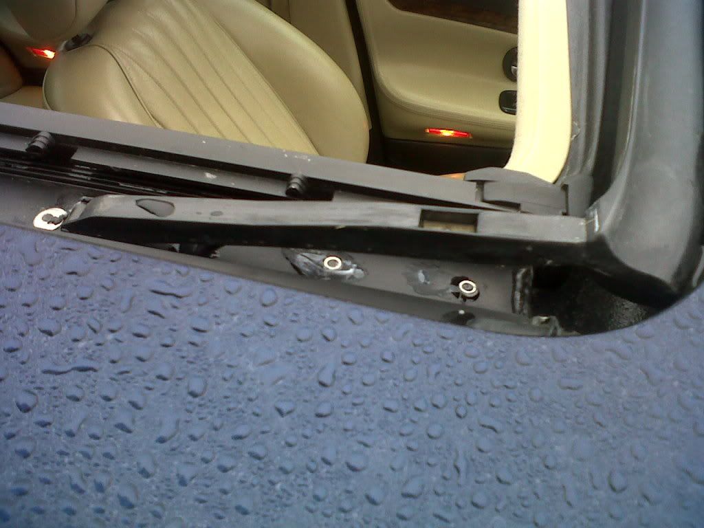

Since this is a numerically significant post ill put up something useful, here for all of the ornithologists who frequently use their sunroofs for ornithology is a picture of the problem causing rivets, get a blob of silicone into them the more the merrier, and your leak if it isn't caused by a blocked pipe end should go away, remember to do it on the other side.
Excuse the untidiness of the silicone application, i have since removed the excessive bits of silicone as it only needs to go to the inside of the rivets, the excess was caused when i lifted the silicone gun out.
