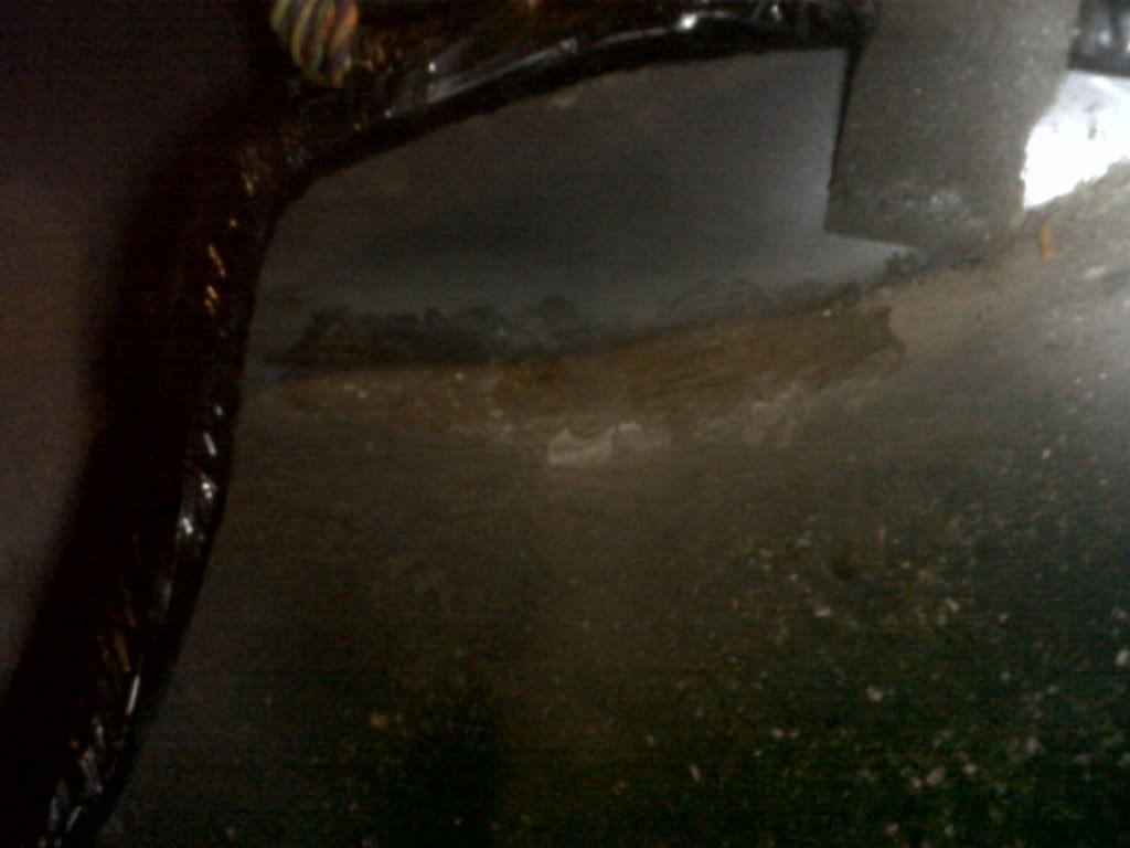

Yip i found a bit of rust under the rear seat, must have happened due to the leaky door with no seal sheet. Heres the rust:
Ok its not exactly advanced corrosion, just a bit of surface rust, but ive scraped most of it away with a wire brush, what now, do i paint over it with something but what with, and does waxoyl come into the equation.

Sorry I can't really see anything :?
Re: A dab of Rust
its there, in the place under the back seat, and ive basically cleaned it all away with a wire brush, but what should i paint it with now.

I'd get a load of that Kurust or other rust eating stuff, slap loads on then maybe some hamerite & paint the colour over the top. The more protection it has, the better.

is waxoyl the same as krust, will it do the job? Theres bits of metal that are now completley bare from my scraping.

Waxoyl is more of a rust prevention for areas that haven't rusted (yet) whereas the Kurust is a remedy that can also be used as a primer.
