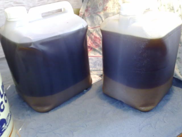

Ideally keep it in the plastic Cubee, let it settle for at least 1 week then filter the good oil.
It will prob end up looking like this:-
Good oil at the top that needs filtering. Pour all the crap all together and continue settling, eventually more good oil appears.
You need to filter it down to 1 Micron, then put into the car.
You can buy filter bags on ebay, just search for "filter bags micron", or instead buy filter housing which you'll need a pump to pump the oil through.
