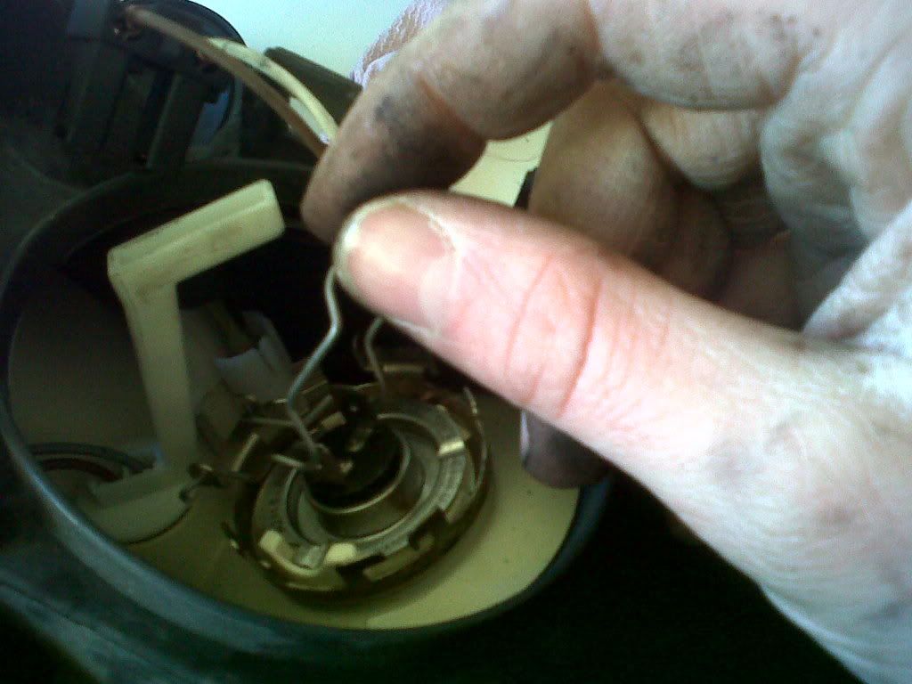

Ok so now the headlight needs the bulbs taken out, unclip things twist things pull pry and they should come out (vague but If you have the headlight out you should know how to take a few bulbs out) don't touch the glass of the headlight bulbs or your finger will fall off (only joking its just not good for the bulbs to touch them):

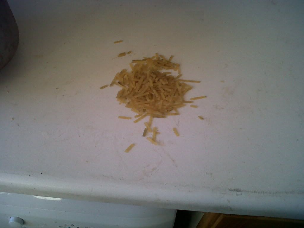

At this stage I tried pasta to try and dry out the condensated light:
F**king balls the pasta just went all pasta soft and I had to fill the unit with water to get it out.
After a while I tried rice, just as bad:
I then tried a hairdryer sat it facing the light and left it.
