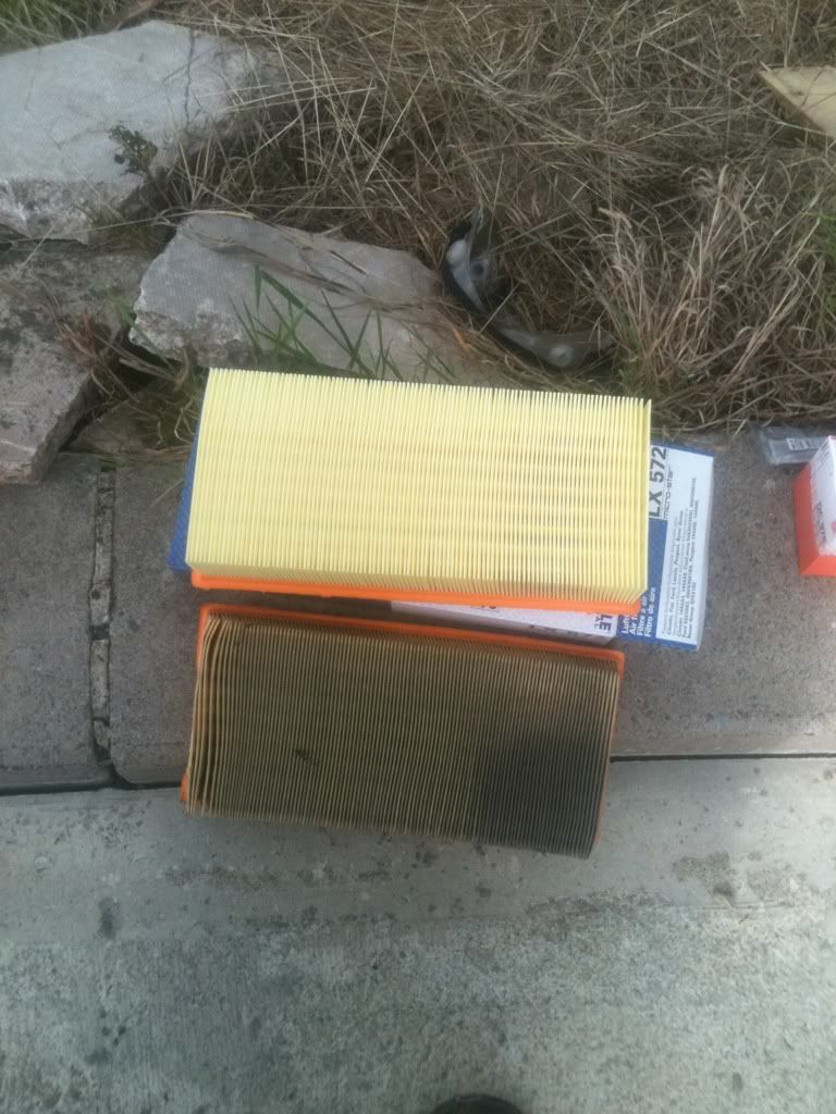

I gave the engine the quick service it needed, its been about a year and probably 10k miles since i last did the oil and filters. So i got a new fuel filter, oil filter, air filter and oil, didnt get the pollen filter because its ok. It all cost £45 although because i didnt know which fuel filter the shop gave me both so i can refund the one i didnt need.
Heres the old and new air filters:

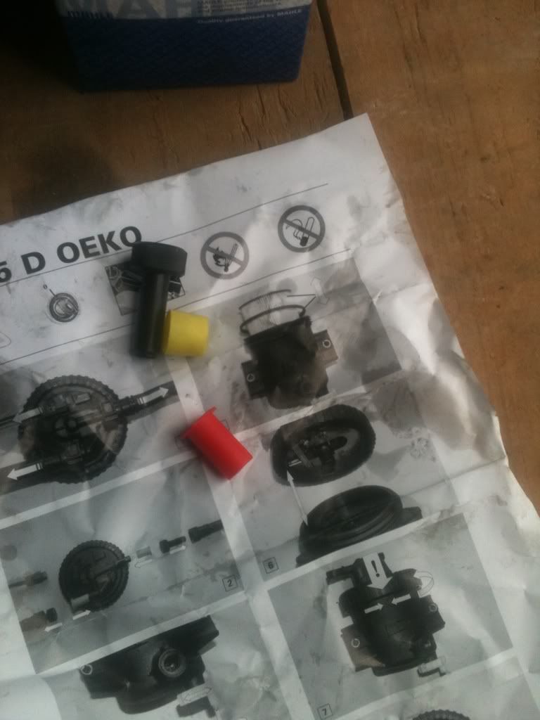

Just something about the fuel filter i got a bag of bits:
the instructions are just pictures no writing so i still dont undersand what these bits are for, and a seal also came, the picture just shows it sitting round the filter which is absurd, so i put it round the thread of the cap but its not doing anything there either, what way does it go on, and if i hadnt got one on before do i need it now?

hi m8,
the fuel filter items are to stop the diesel draining back when you remove the old filter to aid restarting, there meant to be removed on reassembly :wink: the gasket sits on the top of the fuel filter housing, you remove the old one (pick at the top of the housing you will feel it) and it will all become obvious where it lives :)
