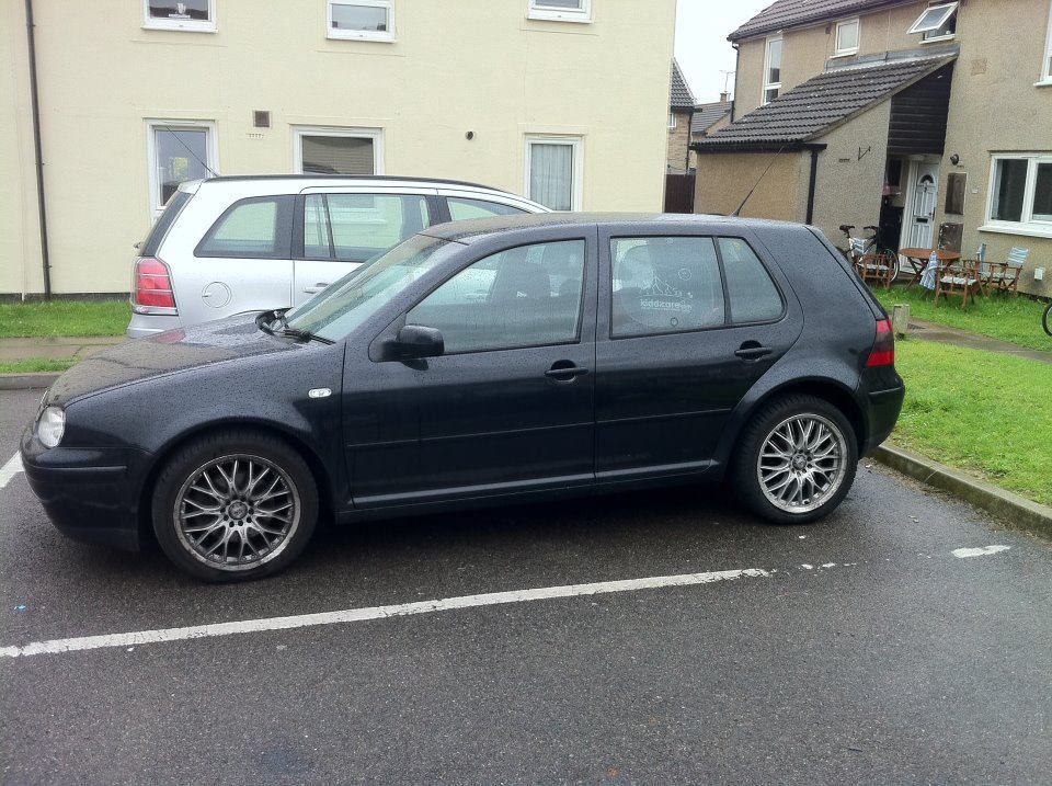

i know im not on here much these days but hopefully some1 can shed some light on my problem.
ive just bought a 2002 VW golf gt tdi in black with the intention of re-selling it. (really contemplating on keeping this but the profit margine on the resale is gonna be quite a good one)
anyway the car has 166k on the clock and is the 1.9 tdi engine with 130bhp.
the only fault i car is the airbag light is stuck on... how do i get it off ?
heres a pic before ive done anything to the car. i only paid £1200 for it and plan to resell it for about £2600 once ive tarted it up...
its a very nice car drives brilliant ..excellent condition 6 speed box. cruise its got the lot
