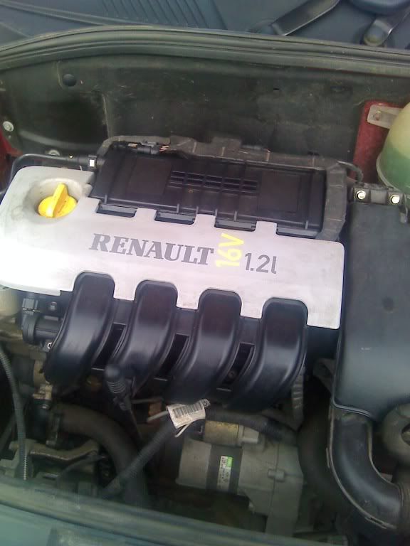

its a 2002 clio 1.2 16v.
Its symptoms definatley feel coil related, although the spark plugs probably need changing also. So any fault code reader will tell me whats wrong, what sort would also remove the airbag light?
Im not a renault fan either, Its engine has all that plastic tat sitting over it:
i havent a clue what that is, is air actually going through them plastic pipes.
The old fiat was much better once the air filter come out of the way you seen every thing, throttle body, spark plugs, etc
i seen the fiat the other day in belfast still buzzing away, i still miss it

[quote="FarmerPug"]its a 2002 clio 1.2 16v.
That plastic tat, is amare to remove,
they are one horrible engine to work on,
if the timing belt is up for Renewal, sell it quick

i have no idea about the timing belt ill need to check the service history, but its may be unpleasent, what i found odd was when i changed the air filter which is on the right i shone in a torch through the hole behind it i could see bits of engine in there i think i could see the cam or valves which is a bit odd. is that plastic thing a rocker cover?
Re: Renault Clio Cutting out at junctions
Theres plastic caps that fits on the end of the cam cover,
if theyre missing chances are the timing belt as been changed,
The plastic thing is the inlet manifold,
on the Megs its a good hour to get all that crap off, abit like De-shelling a lobster
