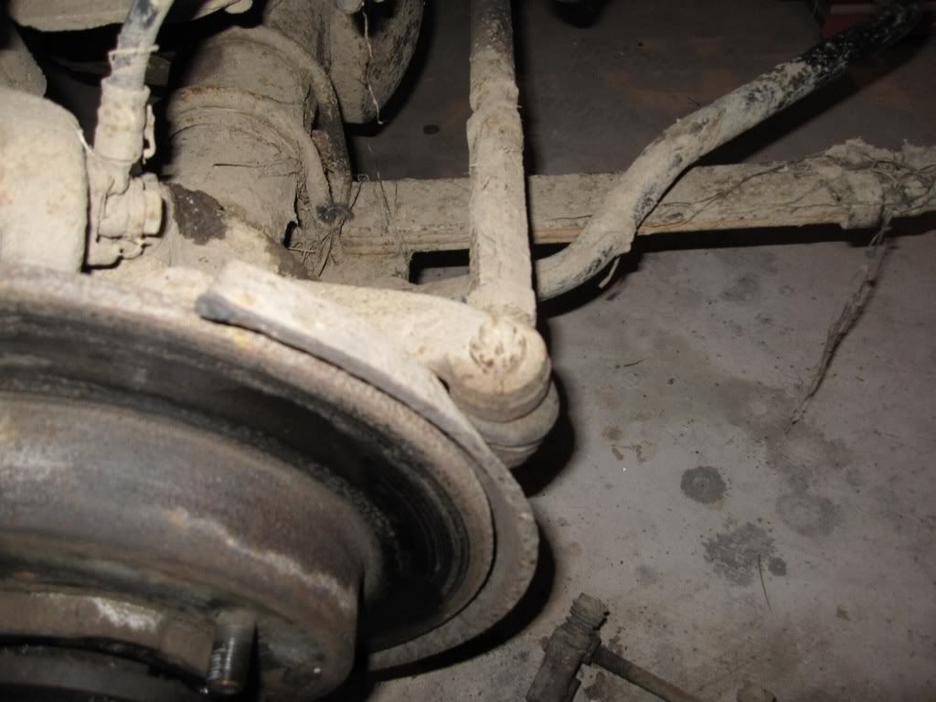

Im trying to remove the front axle on the suzuki, these bolts that hold the steering linkages on don't turn, theres is a tab or something in the middle of them that doesn't let the socket on them:

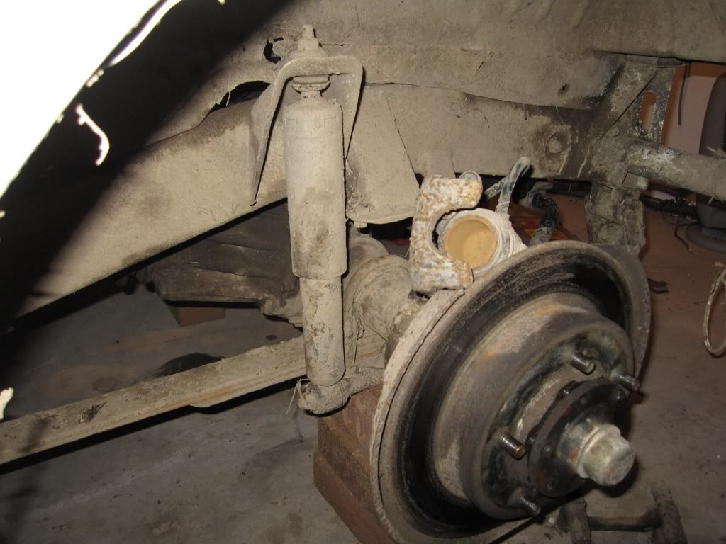

and I've heard about springs needing compressed, does this apply if its just a single shock

FarmerPug wrote:Im trying to remove the front axle on the suzuki, these bolts that hold the steering linkages on don't turn, theres is a tab or something in the middle of them that doesn't let the socket on them:
That looks like a castellated nut with the remains of some split pin oxide fused onto it - it was once like this....

picture 1 if its the trackrod end your on about there'll be a split pin in the crud that needs removing then a socket will go on
picture 2 nah its a leaf spring so just unbolt the damper

A bit of bashing at the pin to get it out then, it seems determined to stay where it is.

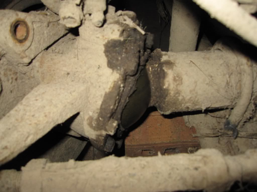

The brakes have failed but i can't see any leakage round the callipers, though these joints seem very damp:

if the pin wont come out,
get an old socket and smack it on and get a breaker bar on it,
are you removing the leaf springs?
if you are id be careful mate you will need to take the weight off the spring or it couid injure you,

Its sitting on bricks right now, the bricks are on the axle, i suppose i need to lift the body up off the springs to take away the tension.

Bend up the tab (old split pin) soak it in WD40 and fit a hexagon socket on it then breaker bar.
If you are refitting the nut, after tightening it up drill a small hole for a new splitpin.
The oil is leaking from the axle through an oil seal inside the ball fitting....needs new seals.....not an easy job.
