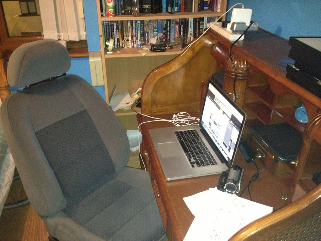

This is one good way to pass the time on a sunday:
A 406 office Chair, quite possibly the most comfortable office chair ever :cheesy:

There is a bit of an issue with this office chair, its about 2 inches too high, i cant reach the ground or fit my legs under the desk so some tweaking will be required

steve_earwig wrote: Btw how stable is it? Is it not a little top-heavy?
Its spot on, it feels more balanced than it did with the old top on it, the metal base the seat bolts to is quite heavy which moves the centre of gravity lower, so it doesnt feel unbalanced at all.

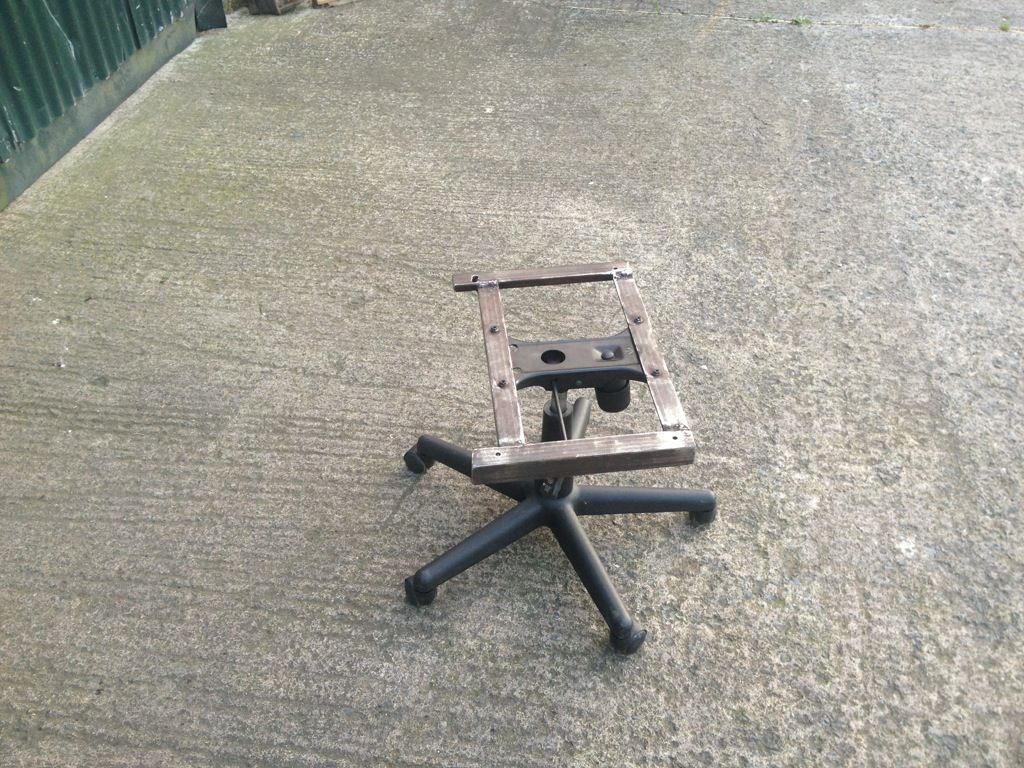

The materials needed are quite minimal, a solid bar of metal, this was just an old bit of angle iron, cleaned off the rust with a flap disk on the angle grinder, cut 2 pieces the length of the original seat runners, and cut another 2 pieces to the width between the bolts, welded it together square with a stick welder, drilled out the holes on a pillar drill, bolted the frame onto where the old seat base went, and onto the top of the frame goes the chair.

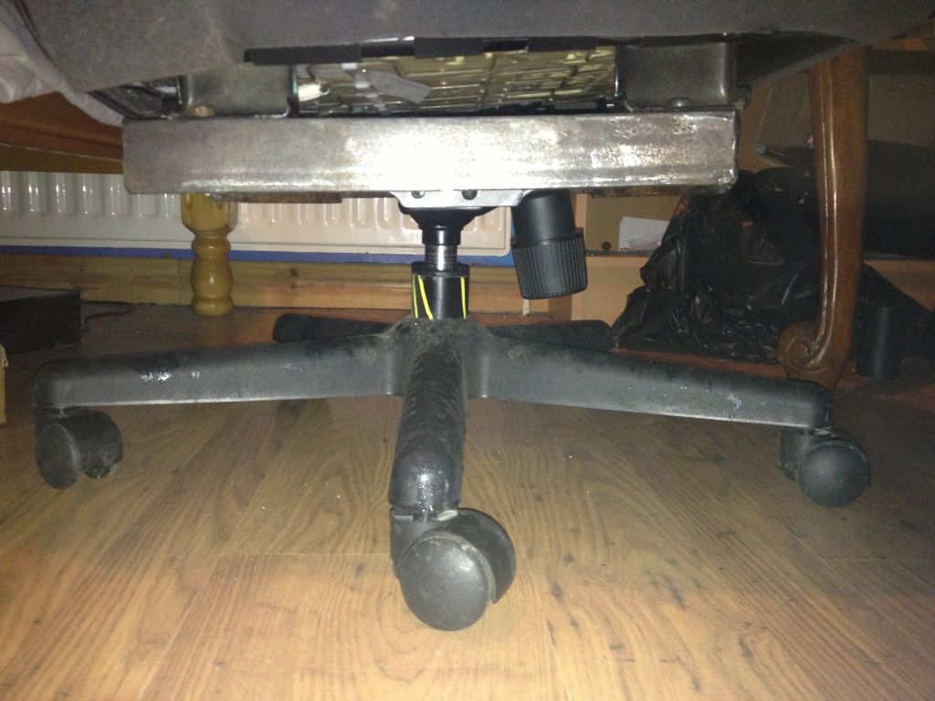

You can beat the gas lift out from the chair ( hammer the underneath ) and find a shorter one to replace it, to make it lower, if you like.

Re: 406 office chair
Thats what i did with my old desk, had it sitting up on 2 big blocks so i could get the chair in, the problem was it slipped off the block one night and it wasn't too pleasant on my knee.
Here is how much of the strut remains:
I dont think there would be a smaller strut on any desk chairs out there, the main problem is the base of a 406 seat is so much thicker than a regular chair so you have to remove the height from elsewhere
