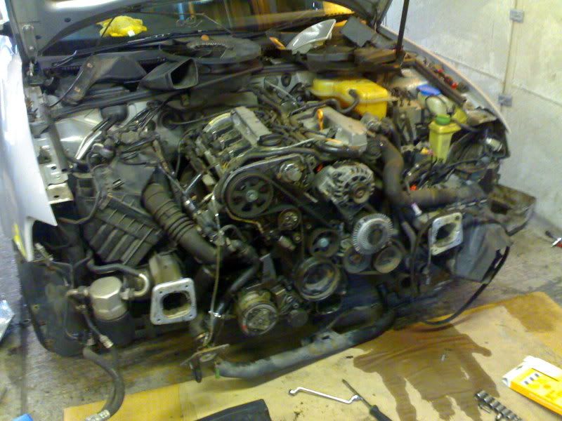

well i got it stripped down last night
like this:
only to find the belt had been changed, why had it failed? the exhaust cam had seized, i managed to free it off without snapping the cam, i eventually got it all timed up and tensioned, went to start... no compression whatsoever
the belt only cost me £20 so thats not so bad, now i just dont know what to do with it, it at least needs a new cylinder head, but i wont know if i need pistons till i take the head off, i really dont know if i can be botherd with it anymore
like this:

That's some "strip down"

In an evening too!Welton wrote:That's some "strip down"
Re: back from the dead... well not qute
I notice only one cam sproket when I thought this was a 20v maybe the other cam is chain-drive?

*jealous* wish I could get that sort of access on my V6...Welton wrote:That's some "strip down"

inlet cam is driven by a chain at the back of the engineWelton wrote:I notice only one cam sproket when I thought this was a 20v maybe the other cam is chain-drive?
Carry on.....
its quite simple to get it like that, only about 12 bolts/screws, drain the rad, remove the bumper with headlights, then unbolt and remove lock carrier
im going to take the head off on sunday to check the extent of the damage
