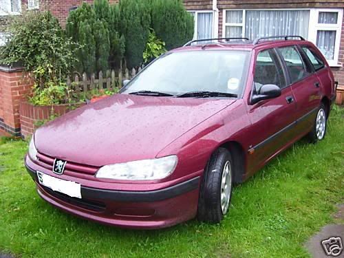

My bro has finally joined the ranks of 406 ownership, having picked up this beast today:
It's a 98 1.9TD SX estate - drives nicely & looks pretty good.

Someone's scribbled white paint all over his number plate :x :x

Looks pretty tidy Doggy! :)
