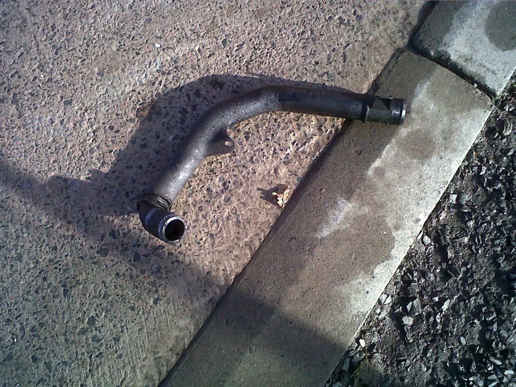

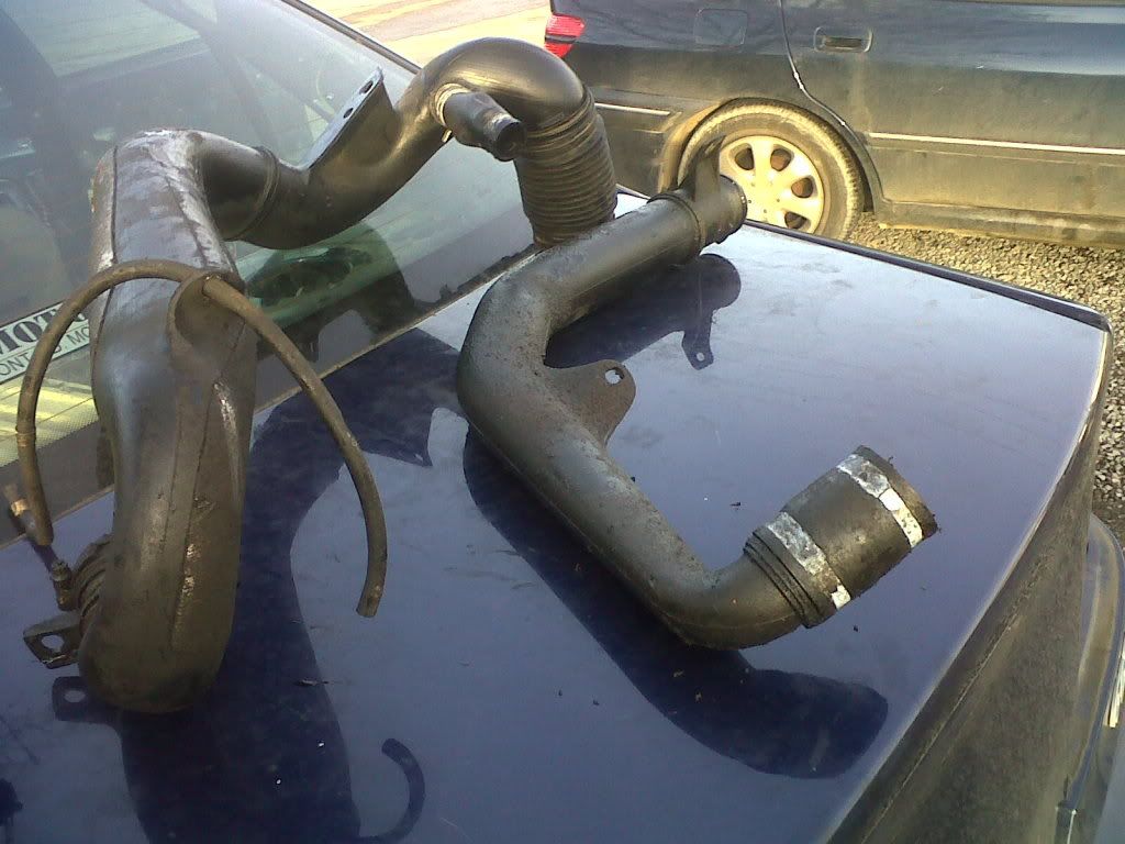

Ive tried my best to keep the bolts and fiddly bits in a tray, but i dont see all the jubilee clips, and im not sure if every nut and bolt is there. Although i can say the pipe come off today just held in by one more jubilee clip. Then i got another pipe off that went into the turbo. A bit ackward but its done:

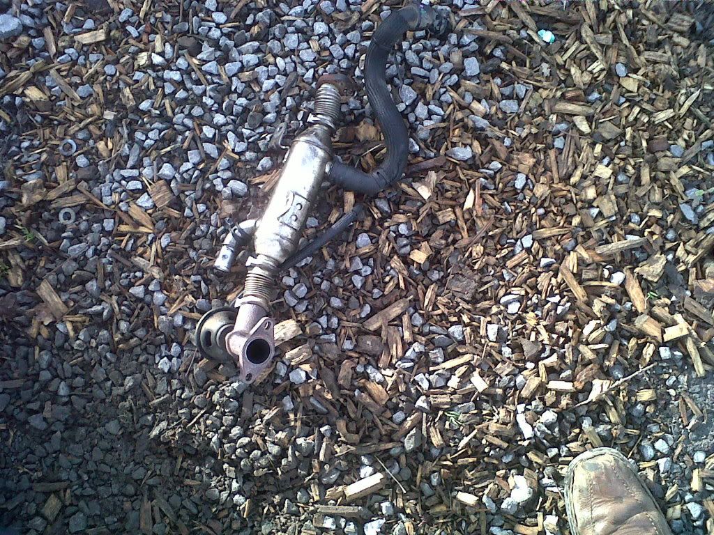

Now i can see the turbo, why is it so out of the way, and how hard is it to take it out completley? Also i took this out what is it:

EGR with transfer pipe and water jacket. Next.
Re: Im breaking a car
I can't work out whether that's a nifty way of warming something up quickly or cooling down the eggsauce gas as it gets stuffed back in the engine (to reduce N0X)
Mine has one of those and despite no sign of the mythical electric heaters it starts clearing frost of the screen almost straight away
Maybe replaced the electrical heater then, makes sense if you think about it as it will take the load away from the altnernator.
The electrical heater was supposed to be a series of resisters in/on/near the matrix - mine appeared to have it as it was able to produce heat fairly swiftly from, what felt like, cold/cool heater matrix hoses
- Posts: 19812
According to Service Box 406 HDis don't have them, I did manage to find them on me dad's C5 though
