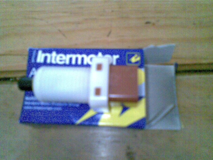

True, I had a hesitation at low speed issue that turned out to be the clutch switch. Easy to fix (just pop off old and pop in new) and only £6.turbolag wrote:There's not much extra to go wrong. Most modern pugs that don't have cruise already have all the necessary hardware except the switchgear. Fit the swtiches/stalk, activate it on Planet and you're away in most cases.
It's proven to be reliable too, the few reported faults being usually attributed to nacked switches on the pedals, which are a doddle to replace.
Even on non-cruise I was reading that the clutch dipped causes a bit of fuel to be added to stop it stalling, and braking causes fuel to be cut? Or is it the other way round?
