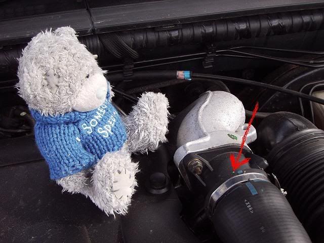

Sorry Supa, I'm not helping much am I?
I haven't got a 'doser' so can't check anything for you. Maybe someone with a newer car could check?
Hope you get it sorted without too much fuss.
Re: HDI turbo not kicking in
I'll hopefully take a couple of piccies tomorrow supa that might help you

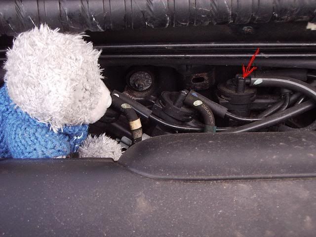

the electro valve thats arrowed is connected to the air dozer
and when my air dozer packed up the car wouldn't start

Hold on - who said we could change from Tinned Food to fluffy bears?
hey, but if it works then what the hell
carry on......
carry on......
thank you kind welly, teddy was the first thing to come to hand
Maybe Pug changed the design
Supa the one on mine looks exactly the same as the one you are holding
hope this helps
hope this helps
