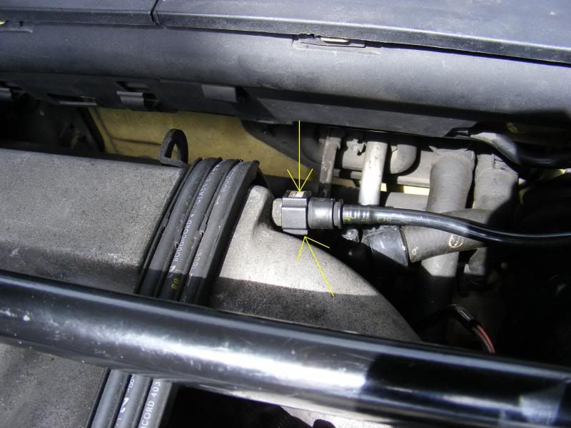

(Image borrowed from MrV6's ES9J4 spark plug HOWTO on the coupe club. Hope he doesn't mind...)
There's the AC pipes going into the bulkhead just to the left of the coolant pipes. Inside the huge rubber grommet(?), both pipes are apparently connected to (welded into?) the large plate. Wonder if I can manage to get the plate off with the manifold and strut brace in place... That'd save a whole lot of dismantling round the back at least
