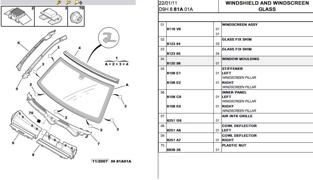

i went onto servicebox and looked at windscreens, but couldnt find the clip:

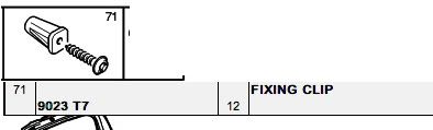

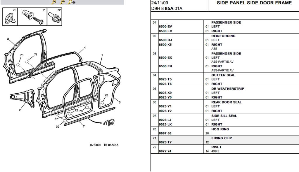

so i went to side section and found it there:
here is the offending item:
I went an priced it in servicebox 89p inc vat. Are these available on ebay, or can joe public like me buy off servicebox?

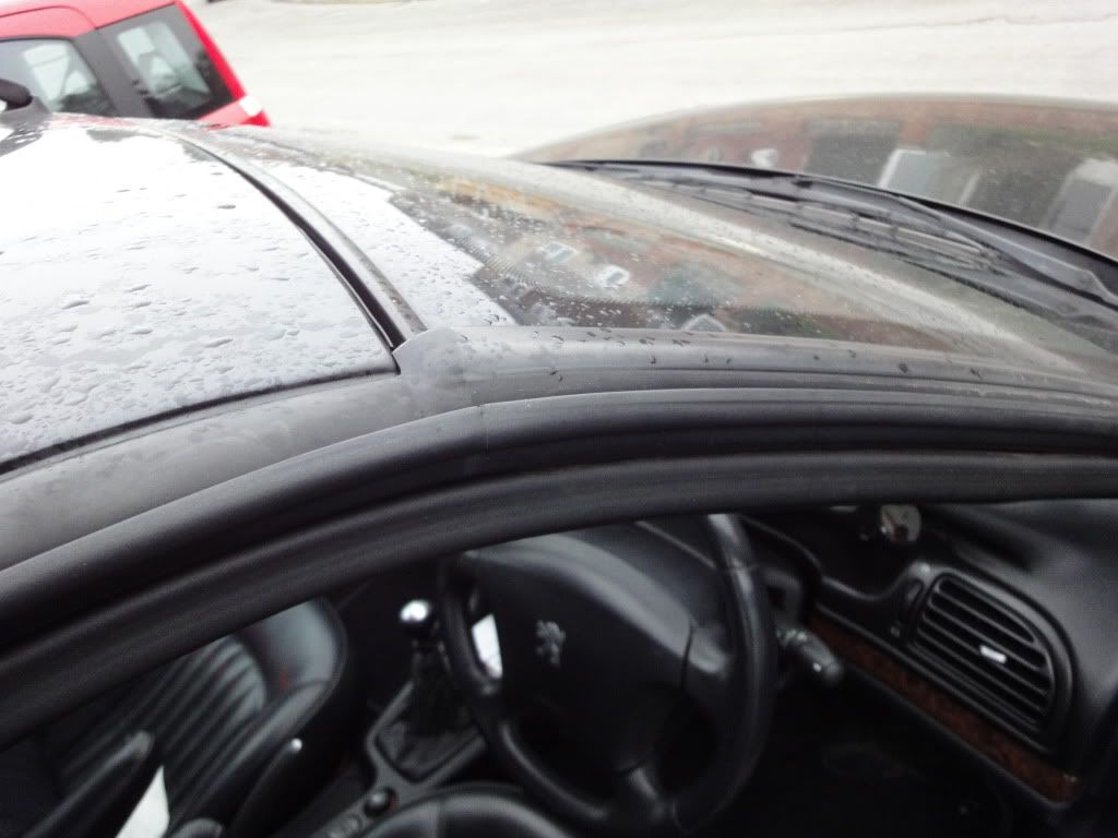

Farmer, here are the pics you requested. I'd say mine looks the same as yours....
Re: Sunroof
Fantastic captain, great photos, so i now can say the top bit of rubber on mine doesnt go as far as your but the more important aspect is your seal along the a pillar is flatter, wheras mine is lifted up a bit because of the clip sitting out.
Thanks.
