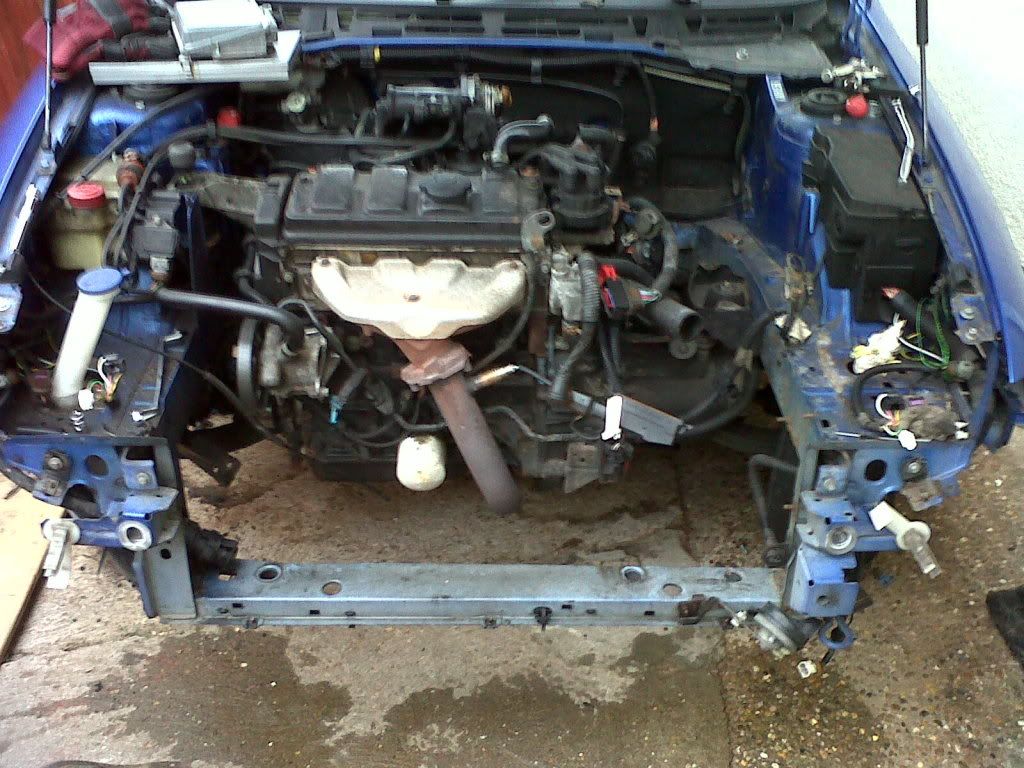

Anyway some pics of whats been going on at Bickle towers :arrowd:

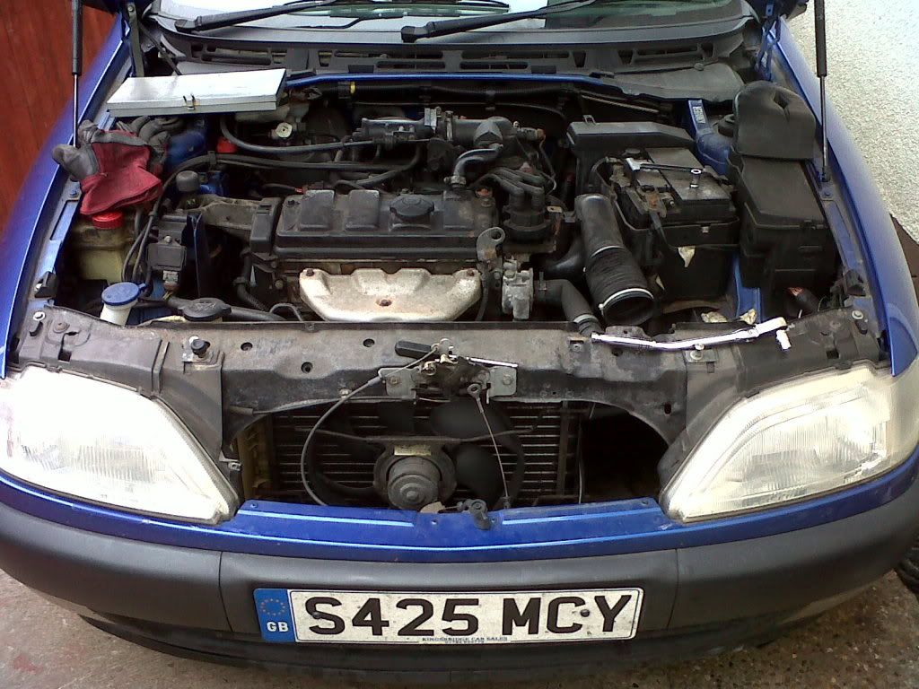

Engine bay pic before work started, the little 1600TU engine had breathed its last :twisted:

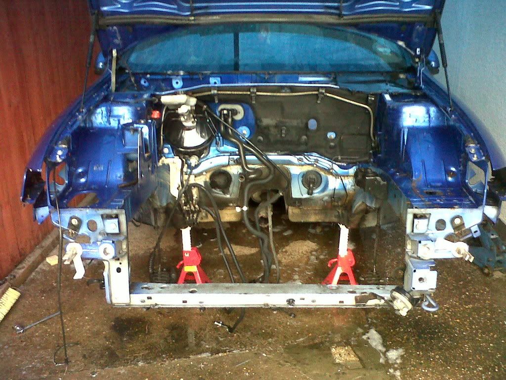

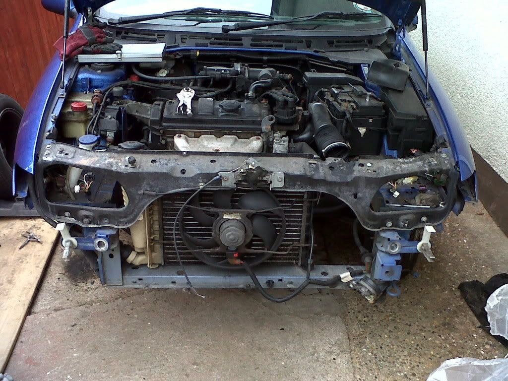

Next i started to take the front end off
After more stripage

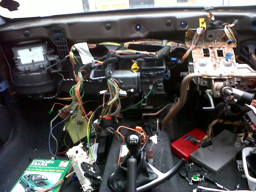

Then it was the interiors turn, dash out to attack the wiring loom, the trusty Haynes manual helping greatly here :shock: although compared to the 406 loom(S) this one is childsplay :roll:

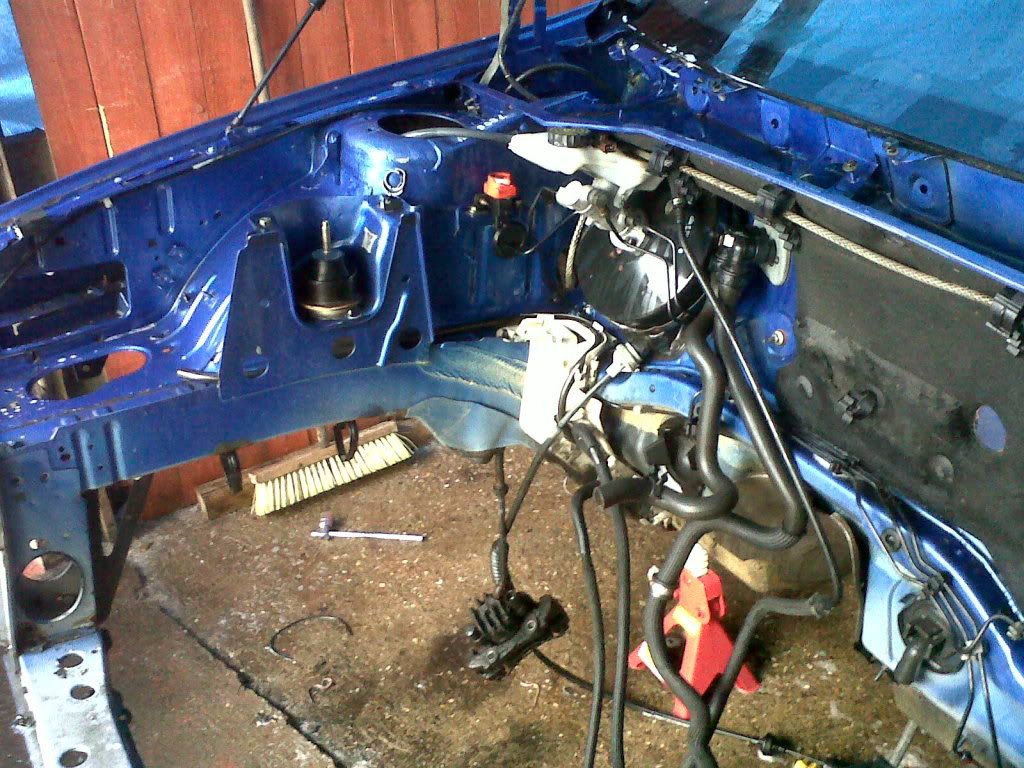

A bit of spanner work saw the subframe, driveshafts, struts, hubs, gear linkage and water pipes removed and finally the engine could be dropped out the bottom 8)
then the wiring loom and fuse boxes could be removed along with the power steering resivoir and washer bottle.

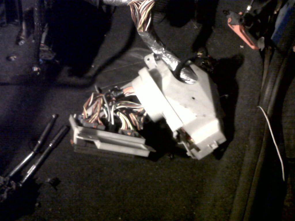

As with the engine bay fuse box i realised the big 406 fusebox was never going to fit into the xsara dash :(
So it was a case of stripping both fuseboxes down and reassembling the 406 wires and relays into the xsara box, Luckily it seems all circa 98 fuse distribution boxs are all the same allthough the 406 one used a LOT more fuses for all the extras :roll:
Below is a pick of the 406 fuse box, being black it doesnt look that big, but its a lot bigger than the xsaras :arrowd:
