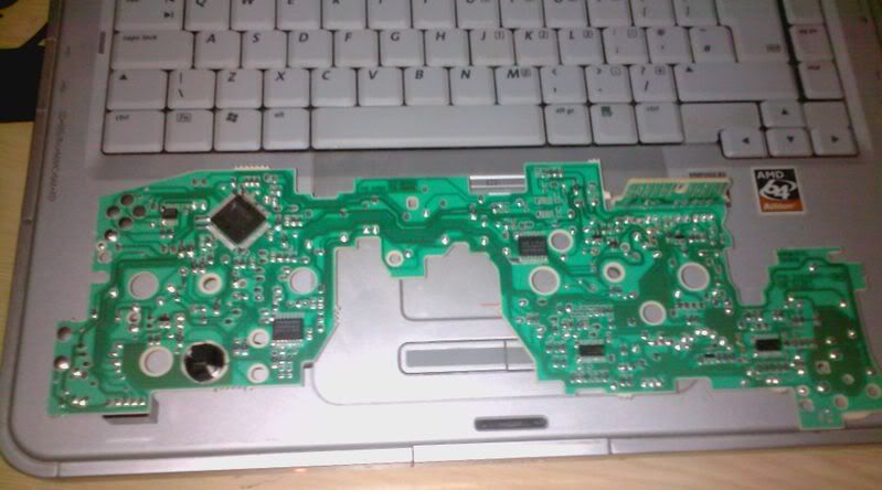

OK, finally got the PCB out. The clippy thing on the flat ribbon flew off and hit me in the face :(
Right now I'm poised over the board with a hot iron, dripping molten solder everywhere. But my question is, which connections am I meant to be resoldering?

To be honest I did the entire board! Also when you re-assemble it bend in those prongs a bit on that clip that attacked you :lol:
I lost the fuel gauge on mine and it was because one of those teeth wasn't pressing the flat cable onto the riser pcb hard enough :roll:
