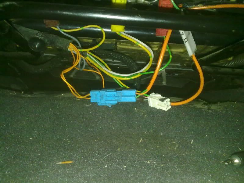

Sorry I didnt explain too well, under the drivers seat there's a random white 4 pin style jobby of which i couldnt find the other end for, theres a similar white connection block under the glove box also unconnected and no sign of its companion either, merely wondering what the devil they were for, just trying to see if someones disconnected a few things in the past or something.
Might try another wiggle/fiddle in the morning
this little fella is the offender
Re: "Sausage" light confusion.
The fat orange wire with 'Pre Tens' on it is for the front facing air bags and will bring up the orange AIR BAG warning on the dash.
The sausage-head light is red and is for the side airbags built into the seat backs (facing the side windaz) looks like a man with a sausage on the side of his face (nice).
I dunno what that white 4-pin jobbie is for :?
Extinguishing the sausage man is somewhat of a mistery I seem to remember. I have a funny feeling the side airbags are controlled differently to the fronts.
My T reg said side air bags on the seat base (a little sticker) but I had no sausage light and no other evidence of them at all.
Around the back of my (leccy) seats in the area where rear passengers feet would easily catch underneath the front seat base I had yet another single-wire connector and it always seemed to help the airbag light when I fiddled with it but again I had no idea what it was - in fact under the drivers leccy looked like a mullered BT telephone exchange to me :shock:

Well successfully got rid of the flashing airbag light with liberal usage of insulation tape under both seats :supafrisk: , might just attempt the same with the little red clip i guess, hopefully with less swearing due to stabbing myself with copper wire :roll:
