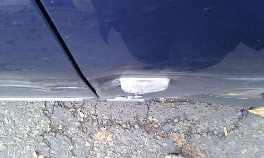

I've had the unfortunate incident of someone reversing into me in a car park. Loss adjuster has decided to write it off. I'm thinking of claiming the salvage as i can live with a dent in the rear door. The front door is a different matter, all i want it to do is be able to lock the door as the central lock system seems to think the door is open, so locks then unlocks. I can open it from the inside. What do you guys think, buy a new door handle and cyclinder, would the remote central locking system work with any locking cylinder? Door pilliar is fine BTW. Would i need to prove the repair was satisfactory?
Has anyone had any experience of putting a Cat C back on the road. I'm not fussed about only ever being able to get third party cover. They've said the current insurance policy will continue into the summer. I understand that it needs an indentity check which is about £40, no problem, but can i still drive it on the road without in the meantime? Will it also also need an MOT?
See below for damage done :cry:

i would take the door panel off and have a look first as it might be a rod thats bent on the locking system

Unbelievable how that can be a write off, its just a dented door at the end of the day, salvage door from the scrapyard for £25 and job done as its a fairly common colour, or sort out the jammed door lock and live with it until another door comes along
As said, I would just whip the door card off and have a look at the rod to the handle as it sounds like its bent causing the central locking to bounce, actually looking at the pic, if the door handle is elevated the central locking might think its been held open causing it to bounce as it does when a door is open/ajar
If its been declared a cat C it would need a vic check, I think the directgov website or the dvla site will have more info on that
Looks a clean 406 aswell from what I can see of it in the pic

I think I'd have the door panel off and roughly beat the door straight with a lump of wood and a club hammer.
