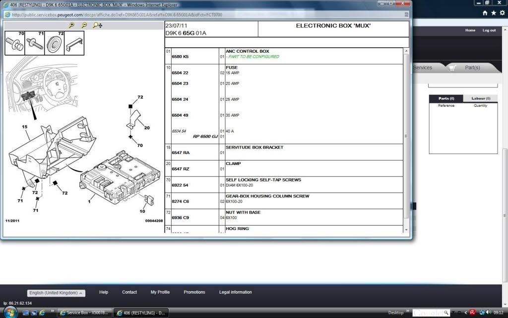

Re: BSI info
I think it's above & behind the fusebox......
Looks a bit like a fusebox itself
- 2.0 16v
- Posts: 125
- Joined: Thu Apr 08, 2010 1:50 am
Re: BSI info
Thanks Doggy. Actually below and slightly behind the fusebox.
It should slide forward on rails but something holding it towards the back of the unit..
Getting there but any help would be appreciated...

Re: BSI info
It clips in to the housing, normally there is a small metal bracket front right which you remove and then it should come forwards with a little persuasionMalc wrote:Thanks Doggy. Actually below and slightly behind the fusebox.
