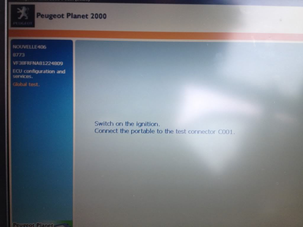

I tried to hook up PP2000 & even that decided to throw a hissy fit.

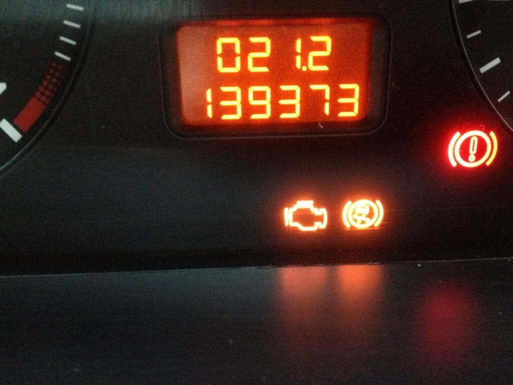

And to make matters just that bit worse, today I have the EML come back on (possibly misfiring, engine was shaking violently even though the engine mount was done, but no unusual popping sound from exhaust) and the ABS light came on too... ABS light has gone back out but seriously? FFS

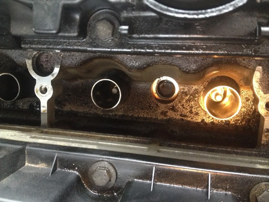

I thought that the spark plugs were already swimming in oil, turns out what I saw through the coil pack was not the spark plugs hole. Some manufacturing hole I have been told...

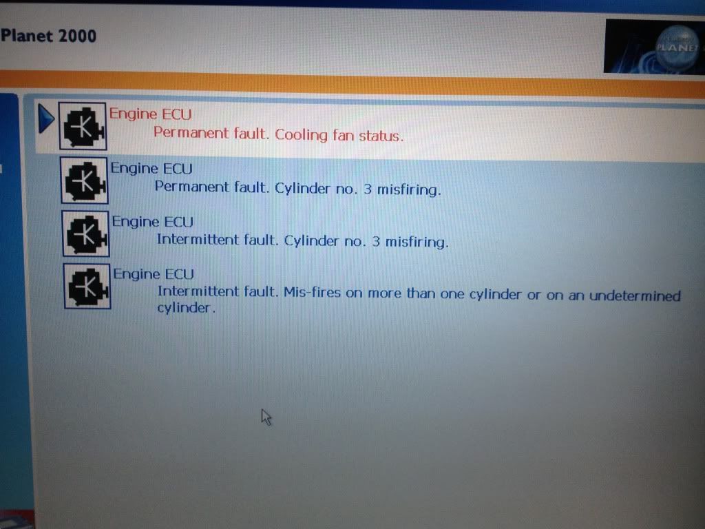

Right so diagnostics this evening:
Previous ''Rear RH speed sensor''
Now? 'Rear LH speed sensor' :lol: :lol: :lol: :lol:
Isn't that just f*cking hilarious?! :shock:
I have absolutely no idea what this means:

Fix the starter, make sure the battery has a good charge, get it running for a while then connect up the PP2000, flat batteries can throw up a load of silly faults, i can remember connecting the machine to a 607, every fault the car could have it had, once a new battery was fitted, and the car was running i cleared the codes and read them a while later and they were gone.
