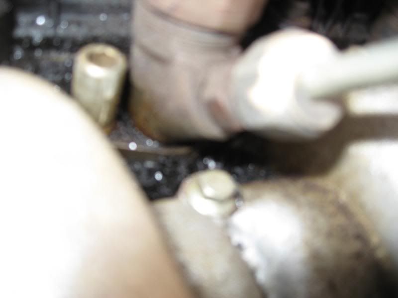

With CJ's recent experiences in mind, I started to wonder if I had something similar going on. I've noticed the following recently:
1. Some tendency to hesitate / nearly stall when maneuvering at low speed minimal throttle.
2. A slight exhaust-ish smell when the engine's hot, waiting at lights etc.
I decided to whip the acoustic hood off and 'ave a butchers, only to discover that a strut brace 'adapted' to fit a D8 completely prevents getting the hood off. :roll:
Amazingly, I found all 6 shorter screws, removed the strut brace, then the hood.
I found a mess around the base of No. 3, (I think) injector, (2nd from gearbox end).
Apologies for the picture quality - I'm hopeless with cameras. :oops:

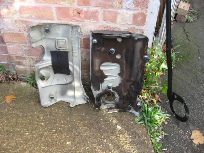

I couldn't work out what this could be, then noticed the underside of the acoustic hood....
...missing some of the foam rubber, just above said injector.
Now I'm trying to think of a way of getting the crap out of there.

When the injector seal on the estate was leaky, and it was only a tiny bit, it was very audible from the engine bay. A "tss tss tss" type noise as exhaust gases blew past the seal. Can you hear anything?
Otherwise we just degreased is very thoroughly and watched how quickly it reappeared. It was quite bad so ended up removing the injector and replacing the seal - has been fine since.

No, I can't hear anything, or see any smoke, just melted foam rubber.

Classic symptoms of a leaking seal. I see this quite often on Ford diesels. I've changed lots of Ford injector seals.

I wonder what eats the foam away? diesel fuel? eggsauce gas? heat?

jonsowman wrote:When the injector seal on the estate was leaky, and it was only a tiny bit, it was very audible from the engine bay. A "tss tss tss" type noise as exhaust gases blew past the seal. Can you hear anything?
Come to think about it, I did hear the noise from 'our' estate, could hear it inside the car, but it sounded exactly like a 2.0 HDi with worn injectors, so I assumed I had swapped a quiet, but faulty set for a noisy, but healthy set. So I didn't investigate any further. :oops:
jasper5 wrote:Classic symptoms of a leaking seal. I see this quite often on Ford diesels. I've changed lots of Ford injector seals.
Btw, second from the gearbox side is number 2 on a French car :D
Interesting, are you saying the foam rubber is a consequence of leak(s), John?
Methinks I'll be doing a leak off test and applying some WD40 tomorrow. :roll:

If you are going to change the copper seals remember to recut the seat. There is a special tool for this, don't use a screwdriver. If the seal has been leaking the combination gases will have damaged the area around the hole in the head that the injectors fits into. Don't recut and you run the risk of the new seal leaking soon and having to do it all again.

I've never had a problem fitting seals without re-cutting the seat, usually the seat is nice and straight when you remove the crap, ideally you should re-cut the seat, but we don't all have the tools.

i've also replaced seals without re-cutting them and never had a problem, definitely looks like yous is leaking if the stuff around the injector is like a black tar, Mercedes engines suffer badly from this they call it black death and on some of them make injector removal very difficult.
i would replaced all of the seals at the same time they are cheap enough to buy.

What I'm still puzzling over is that the gunge around No. 1 & 2 injectors is probably the melted remnants of the missing foam rubber, (some of the bits I recovered were clearly porous - like an Aero bar - just blackened, presumably by the heat). The area around 3 & 4 injectors, (where the foam rubber is intact),is clean and dry.
There is no sound of anything leaking, no smoke or liquid deposits.
Is there a positive test for leakage, or do I just clean it up as well as I can and see if it stays that way?
I have no issue with replacing the seals on any of the injectors that decide they're willing to come out, but 2.2 HDl's are known to be difficult to remove, (my previous success notwithstanding).
I'll check the correction values, do a leak-off test, clean it up as best I can tomorrow and then?
