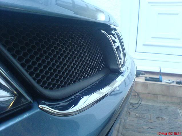

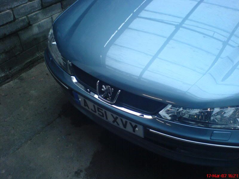

Blinged my ride......
..... with the chrome grille bit :cheesy: :cheesy: 8) 8)
Right here's what you do.....

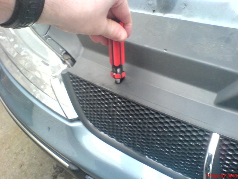

Take the 3 clips off the top of the grille, you'll prolly wanna get new ones of these 'cos at least one will break when you try to get them out... :evil:
then you'll need to stick a screwdriver through these holes (one either side) and press down on the clip to release the bottom of the grille.
The middle clip is a nightmare, I pulled the top of the grille forward so that I could get my hand complete with a stubby screwdriver down the back, then press the bottom of the badge backwards and ram the screwdriver into the clip from behind to release the catch, then pull the grill forward and it's free....

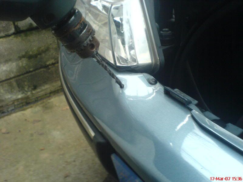

Offer the chrome bit up to the bumper and carefully mark where the 3 bosses need to go through the bumper. Then you need to grow some balls and drill 3off 5mm holes :shock: :cry: No going back now :?

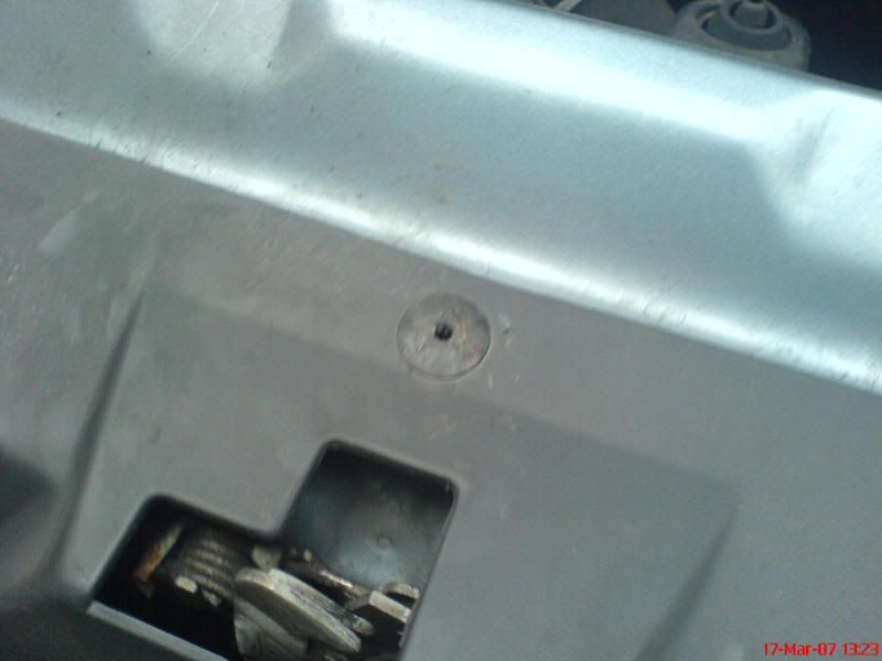

Next thing to do is secure it. It comes with self adhesive pads, and has 3 bosses. I did think about cutting the bosses off the chrome bit and just using the self adhesive pads to stick it on (save having to drill the bumper), but I reckon the corners will lift if you do that.... Peugeot man said you need "star washers" which press over then grip the bosses (item 16 on the EPC diagram). He didn't have any but as it turns you wouldn't have got them on anyway. By the time you've drilled through the outer and inner bumper, it's so thick that there isn't enough of the boss protruding to get a washer onto. So I found some very small self tapping screws that fitted nicely into the ID of the 3 bosses, and fastened these from inside the bumper with washers to spread the load. Word of warning here, I did slightly bulge the front of the chrome bit in one place by driving the screw in too far :cry: . So then used a couple of extra washers as spacers on the other screws.
And there you go, one blinged ride 8)
