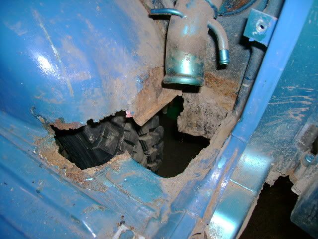

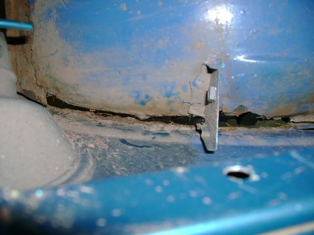

Cool ideadarrenwall wrote:the rear window seals....... the sound proofing is a plastic covered sponge it holds water against the floor without the carpet feeling wet
You don't use salt on the roads over there though do you? There's a big trend here on importing 10 year old Japanese 4X4s at the moment, Now we all now that Japan has it's fair share of rain, but they don't get much snow / ice so they don't salt the roads, and their 4X4s are like new underneath, not a spot of rust anywhere, despite not having any proper rust protection under there. I'm currently looking for a Mitsubishi PajeroSTALLED wrote:As for the Disco - i was always under the impression that they were galvanized. Never heard of them rotting out like that here? Is it just with the S1 Disco's and not the later cars?
Salt belongs on chips - not on roads!DaiRees wrote:You don't use salt on the roads over there though do you? There's a big trend here on importing 10 year old Japanese 4X4s at the moment, Now we all now that Japan has it's fair share of rain, but they don't get much snow / ice so they don't salt the roads, and their 4X4s are like new underneath, not a spot of rust anywhere, despite not having any proper rust protection under there. I'm currently looking for a Mitsubishi PajeroSTALLED wrote:As for the Disco - i was always under the impression that they were galvanized. Never heard of them rotting out like that here? Is it just with the S1 Disco's and not the later cars?, but my budget is pushing me towards ones that've already been here for a few years, and the problem I'm finding is that some lazy owners didn't underseal them when they first came in and as a result they're starting to suffer a bit....
Disco 1s don't suffer the metal worm too badly, just a couple of areas where they're prone to water ingress due to the piss poor build quality as Darren's already said, plus I'm starting to see quite a few needing the sills replaced, My advice would be to use box section like I've done with the zook, let's see Mr MOT man tap that with his little hammeralso acts as a built in rock slider
. The other thing to watch for on a disco is chassis rot, the problem there is that they rot from the inside out, so it looks fine, then one day there's suddenly a hole
