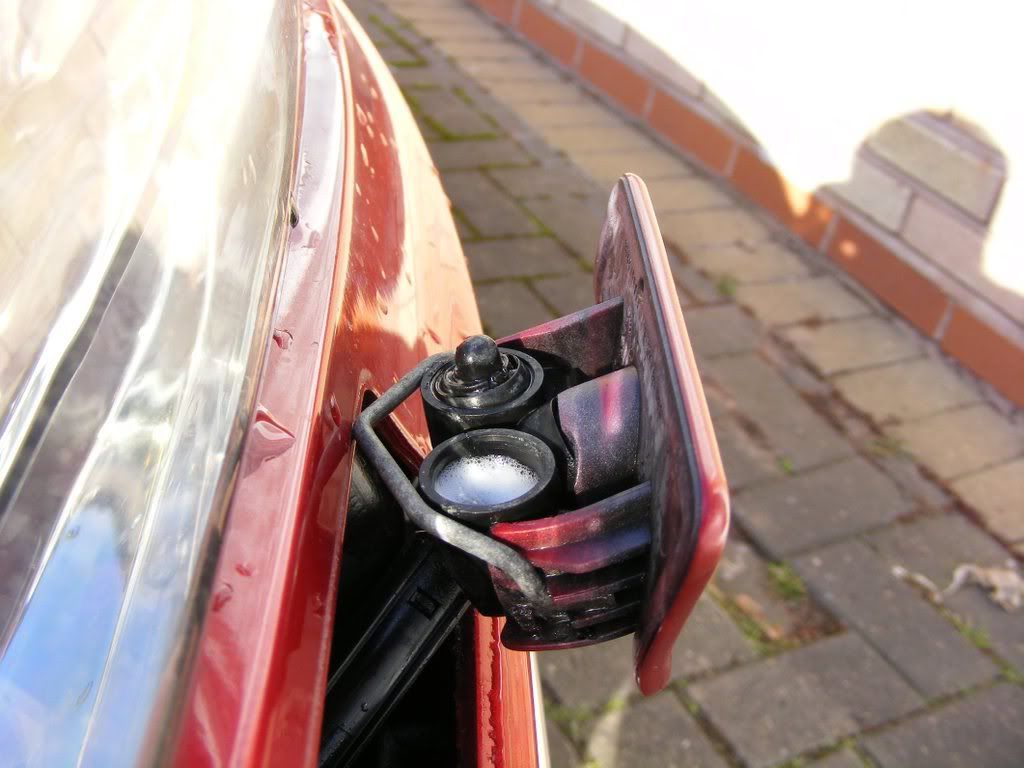

I've lost a nozzle from the headlight washers now everytime i use them water pisses out all over the bonnet instead of the headlights, do peugeot parts dept sell replacements? if not where can i get one from?

Re: Headlight washer nozzle
this is the bit i need, its also hard to block that hole, just tried a big chunk of blu tac but it flew out on the first test, anything else will just end up clogging it up permanently.
You could seal it with silicone temporarily
Make a rubber plug and stick a screw through it so you can pull it out, push it into the hole and silicone around the top.
May I suggest a semi - permanent fix for this problem?
If you measure the diameter of the hole, you could match up a dished type core plug that would be a tight fit in the hole, get any type of washer nozzle / jet, drill a hole in the core plug so that the washer jet will be a tight fit in the core plug or one with a nut on the end, then, using silicone sealer to seal it, knock the core plug into the hole so that it's tight in there....problem solved.
