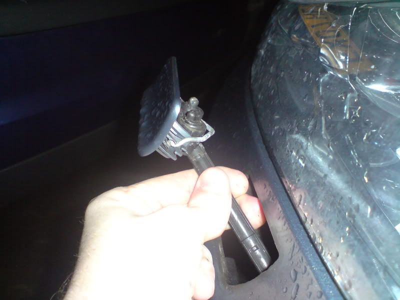

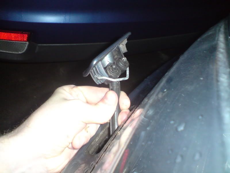

OK we appear to have a crossed wire here....
The painted cover is attached to the "head" of the washer mechanism, the mechanism itself contains a pretty big internal spring, you can't see the spring, it's inside the cylindrical body of the washer mech, the bit that's mounted behind the bumper. The way they work is that the water pressure from the pump overcomes the force of the spring and causes the inner bit to rise out of the outer bit and hence out of the bumper, when you stop the pump the spring pulls the whole lot back in.
Matt, I've been up to see Neil this afternoon and, despite his protests, experimented with pulling the washers up on his coop. They are a bit different to mine but still work in the same way, so go ahead mate you won't hurt it. Get your finger nails under the edges of the cover and gently but firmly lift it, it'll come out about 2" before it stops, then you can hold it out with one hand and have a look / pick at the nozzles.
Re: unclogging washer jets
Here you go Matt, the coupe ones come straight out of the bumper not angled towards the middle of the car like mine, and as a result they won't come out quite as far as these, but you get the point. Should be able to have a good go at checking / cleaning them this way.....
