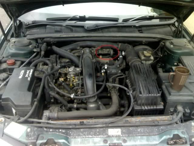

Right, well still no joy. Thus, I went and had a poke around on the French car forum and found this.
Armed with this new information, I wandered back out in to the bright sunshine but freezing bloody wind and took some pictures:
Now, to me this looks like a PT100 with a bowden cable running under the air ducts to the back of the pump. There was a wee small bit of play in the inner cable, and it looked a little rusty on the inside. However when I started the engine and tried to move the cable in hand-o-matic mode it didn't seem to affect the revs. Admittedly there's little point in trying to fix this when it's so cold as it's not supposed to lower the revs until the enjin's warmed up :)
So, the questions:
  • Is this the cold idle controller the fellow was talking about?
    How would I fix it/replace it? I can remove the bracket from its mounting and peel back the gaiter but otherwise can't see how it would come apart :(
    If it's not the cold idle control, what is it? :D
Also, while I was out there melding with things I don't yet understand, I discovered the stop lever. My question here: what effect does turning the screw on this up and down have? I realise if I screw it too far down it cuts off the engine/makes it struggle to start. Is there a point to this screw?

Right, once again I have been talking out of my arse.
What it actually is is a vacuum-operated diaphragm, acting on the cable which in turn acts on the fast idle lever.
The problem: there's no bloody vacuum hose attached to the diaphragm housing. There's the wee stub of pipe where the hose is evidently supposed to go, but no hose.
So, if I were to buy a length of hose - where would the other end go? Haynes is a bit mysterious on this subject. I gather there's some sort of temperature sensor, and possibly a solenoid on the other end which routes vacuum to the diaphragm when cold. Could someone with a working 1.9 have a look and find out where this hose is supposed to go?

You are assuming the fault with your idle is the cable from the vacuum valve highlighted in your photo, have you tried disconnecting the cable from the pump side to see if the problem goes away with that disconnected?

Well yes I am Jasper as there is no hose connected to the valve. Therefore it's not getting any vacuum signal and appears to default to fast idle (unless maybe the lever is stuck in place or something, entirely possible I suppose). Even if I reduce the speed down to 800, it means I'll lose the cold-start protection. Then again maybe now it's warm enough that that won't matter until I can get the pump out and have a proper look.

Right, I have commenced performing my impersonation of a dog at the base of the correct arboreal specimen.
Found a small hose dangling from the vacuum gubbinz. This turned out to be just right length to connect to the diaphragm. It had a split in the end, explaining why it had come off (whether from wear or from heavy-handed 'maintenance', I may never know). Chopped off the split length and dunked the end in boiling water. With some brute force, ignorance and swearing it finally went on. Well, a bit. Will need to find a wickle jub clip or something to keep it there methinks.
Anyway, just a moment or two after, the white 406 a few doors down from me turned up. Accosted the driver and guessed as to the car's 1.9ish nature. She was suitably impressed I could tell just from the sound 8) Anyway, got her to pop her bonnet so I could have a look underneath ( :shock: ) and w00t! Long story short, I'd plugged the right hose in to the right place :D
Now, just got back from the shops. Although the car got up in to the high seventies, the idle still didn't come down. If anything I think it's a little higher this evening, a whisker shy of 1200. So now the whole thing is re-assembled I guess I need to fiddle with the pump settings... or maybe indeed the system is cream crackered.
