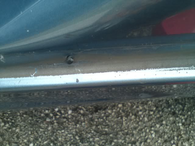

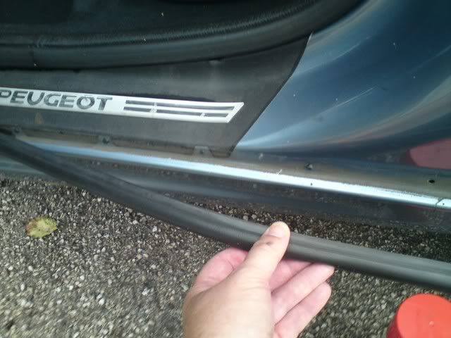

Upon cleaning I noticed once again that the darling public have kicked my sill seals to bits again.
Big boots, heels and alcohol dont do the car any good!
What your left with is this,
Generally a pair of pliers pulled back sharply releases the offending 'hog clip'.
Or sometimes you just dont grip it enough so you have to push the broken bit of the clip inwards with a small drift.

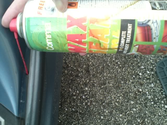

Now's a good time to get in with the waxoyl or substitute aerosol. If you get one with a small nozzle then it makes life easy.
Give it a good wiggle around ina circular motion and you should coat most of inner surfaces of the outer sill.
Gravity will send it down into the lowest part of the sill.

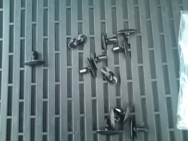

The clips you can readily get from ebay or the stealers cheaply.
The problem is ...they're extremely thin at the 90 degree joint so they tend to break all to often.
The opposite side about to go....but a slip or trip risk for me as I dont want the council putting me off the road,
or Claims direct getting their claws into me either.
Whilst you're there, its worth just slipping a sqirt or two up the door drain holes also.
I've never seen a 406 with rusty doors but having had other cars go its worth thinking about.
