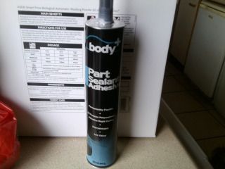

Welp, since a few weeks ago, I couldn't get it to slip but I haven't had long drives - maybe an hour at most. Plenty of smoke and some minor vibration if I boot it though (the remap file is back on
My main concern is the exhaust mid-section which is quite rusted at the joint to the rear box. I applied plenty of exhaust sealant but doubt it will stop it from rusting.
Still need to get everything done before winter sets in (although it seems like it's here already) - don't want it conking out.
