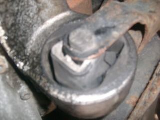

I'm half way through changing my oil and filters and notice something just behind the sump plug, it's like a round housing with a rubber in it the rubber looks perished to me plus theres quite a bit of play in it.
Would this be the bottom engine mount? if so is it just the 1 and am i better off changing it while i'm under the car today? (if i can get one today)

Here's the lower mount:
And what's up with them mostly:
Fit a new one and the car will be *transformed* honestly. Bit of a pig to fit as you're supposed to remove the driveshaft
Another easy test is to have the engine idling and blip the throttle slightly - if the engine moves by more the 25mm then the mount is shot. Mine used to lurch forward by about 50mm

Scotty, the bottom engine mount is located on a sort of arm that bolts onto the back of the engine and onto the sub frame.
Easy to spot as the drive shaft runs conveniently through the middle of the arm making it impossible to remove the mounting arm with the drive shaft in place.
The sensible and easiest option is to remove the drive shaft, unbolt the mount and have a garage press a new rubber in. It's also an opportunity to change the gearbox oil at the same time.
It can be done without removing the mounting but involves lots of cutting, hacksawing, hitting with hammers and copious amounts of swearing and don't forget to have a large packet of elastoplast handy!!!

Yeah thats the one lads but now this isn't my immediate problem.
Sump plug, you know what i'm going to say dont ya?
yes i put it back in and it just turns and turns... removed it and there was wire wrapped around the threads (i've read about this before but not sure what to do now?) new sump from main stealers is £250 plus vat and the scrappys around here are quite frankly sh*t... wtf do i do now?

Back to the original reason for this thread i finally got my photobucket to upload pics so heres what i thought was the bottom engine mount.
Looks pretty beat up to me, the top of it does have the drive shaft going through it looks a pig of a job... Stupid question but is it an mot failure?

mount looks fubard from here
