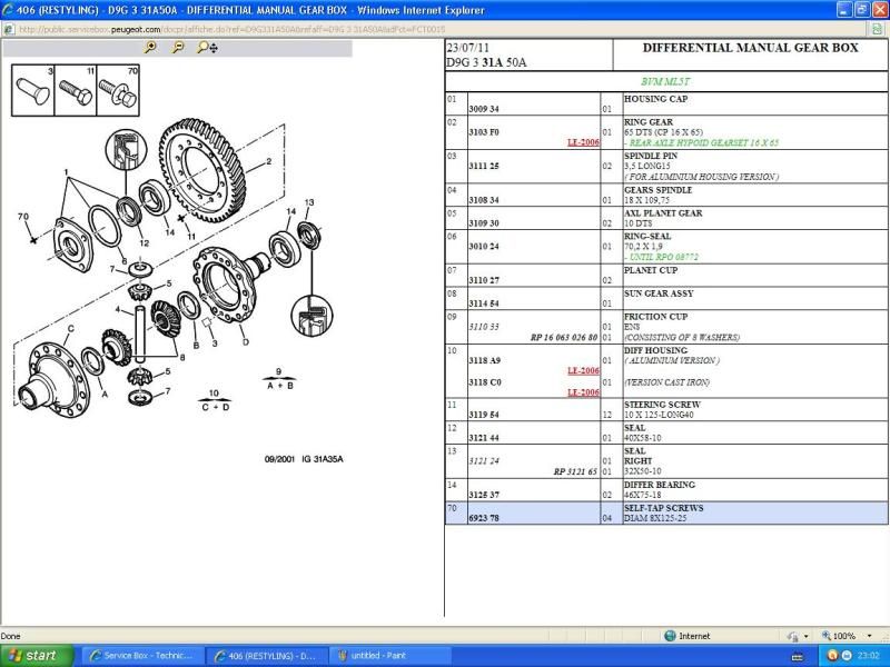

It would help if you said which gearbox you have, (or which engine, as HDi 90's & 110's have different 'boxes).
Re: What do you call this part?
Any good?
(Could be an ML5C or ML5T 'box, but if it's no. 1, it's the same for either):
Reference Description Quantity Price - VAT Price + VAT Total + VAT Selection
0000300934 HOUSING CAP 23.04 GBP 23.04 GBP 27.65 GBP

Doesn't look like it's available separately - I think it's part of the 'Housing cap' assembly, item 1 on the Service Box screen dump??
