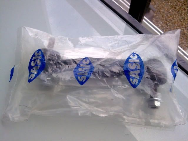

I'm currently in the process of getting the parts ready to refresh the rear end of the 406. The car has done 160,000km and things are getting a tad tired back there - Bit of a clunk and a knock when going over bumps. So far I have bought a set of anti roll bar links but I was wanting to know what else I should replace whilst I have the rear wheels off the car?
Is there another bush which you have to purchase to match these - I can't quite work it out from the manual I have and I don't have access right now to a Haynes? I'm also assuming that I need the link rods - How many do I need...my mate who is a mechanic said he would help me do the work if I bought the parts - I'm assuming it's just the two?
