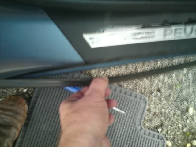

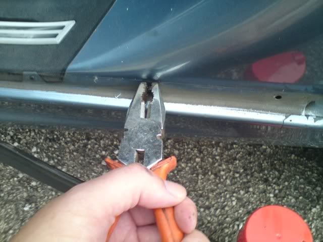

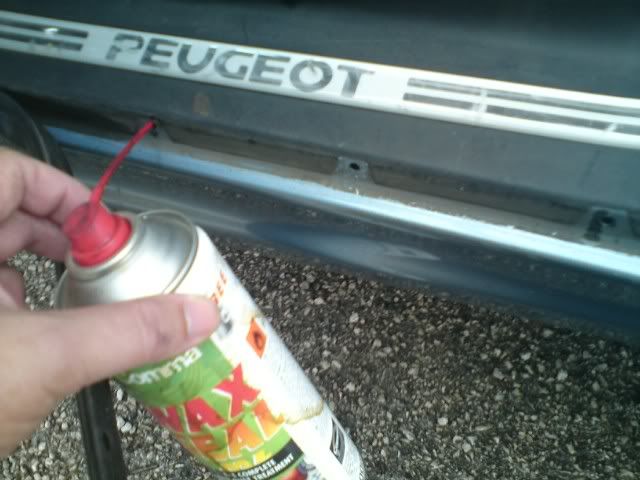

Re: Bloody Tripping Hazards a.k.a door seals?
i remember getting 2 new seals on ebay last year for £25 some new clips and they are easy changed i couldnt remove the old clips without the going into the sills so i put lots of waxoyl in there to stop rattles and rust
