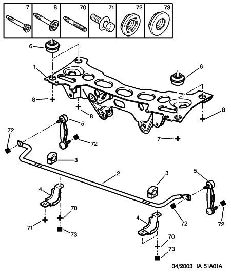

I recently posted a rattle problem on my 406 2004 2.0 HDI estate and thanks for all the comments. Can Gary or anyone please explain what a rear drop link or top link is? My Haynes refers to rear susp lower arm, upper arm, trailing arm and track arm so the top link/drop link must be one of those. Are the track arms horizontal links that travel from the top of the hub to the chassis? At present I'm swapping around the rear shocks in the hope that the rattle will migrate too indicating faulty shock. But I suspect Gary is right and this is wishful thinking on my part. On the bright side, the cost of a replacement top link (DIY) could well work out less than a new shock. Incidentally Kwikfit told me that shocks must be renewed in pairs. Had not heard that one before. In 46 years of driving I've never had a shock problem.
Re: REAR DROPLINKS
the top links travel horizontal. in the diagram they are number 6
upper arm i would imagine and cost about £10-£20 from factors each
Re: REAR DROPLINKS
also toplink and drop link are 2 different ones. both found on the rear.
the toplink (upper) is metal and goes horizontal
the droplink (lower) is plastic and goes vertical
also number 3 = anti roll bar bush can go and cause knocking/rattling but these would be last on the change list as they dont often go
here is a diagram of the rear droplink - number 5
