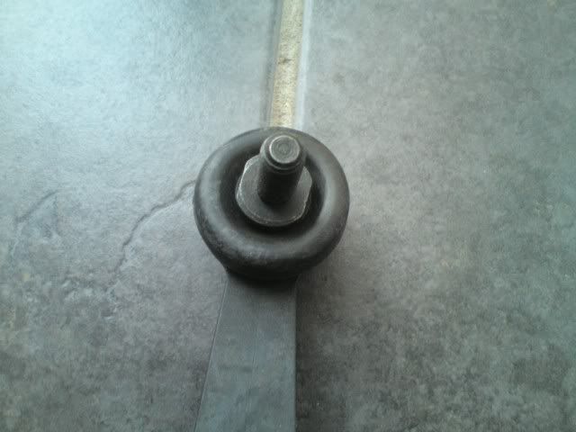

I recently did a rear drop link and took a few pics. I used the ones by Pearl products which are cheap as chips
and also have spanner grips on the stub of each moving joint for ease of fitting/removal.
