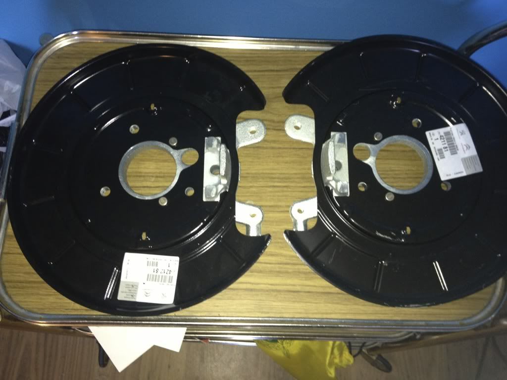

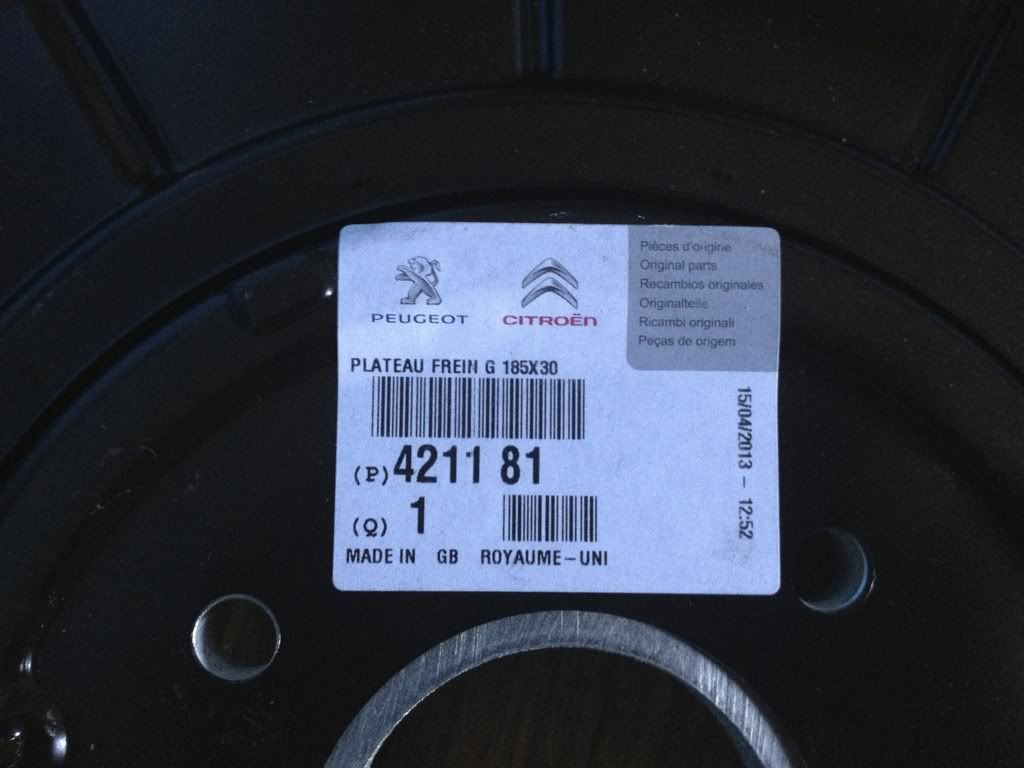

I finally got them:
complete with the lion chevron logo:
They cost £170.68
(apparently 10% off, but id have preferred if they hadnt stuck a 0 onto the end of the price they should be)
I went asking about zinc plating it, it would need sand blasted and then in the words of my cousin "it would warp like f*ck", he says to get it powder coated instead over the exhisting paint, what do you think. There is possibly the argument that this is a 11 year old car but i dont really look at the car as a disposable item if i put a part on it i want it to last.
They cost £170.68

Wow!FarmerPug wrote:I finally got them:
I wouldn't worry about it. I mean, without treatment they last over 10 years before becoming troublesome. I imagine over the next 10 years, you'd need to replace every single part on the car which contains rubber if you were going to keep it. That's an expensive proposition, and if PSA discontinue and run out of stock of hoses etc, it'll be a lot more expensive to have new ones custom-madewhat do you think. There is possibly the argument that this is a 11 year old car but i dont really look at the car as a disposable item if i put a part on it i want it to last.
I'm getting sick of replacing broken rubber bits
