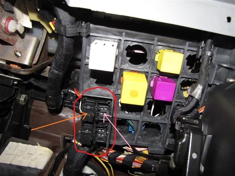

I used the pic of maximillion's fusebox as referance and once I removed the cowling I could see the relay =, there just one fitted in the D8 in the scrapyard, as oppose to 2 on his fusebox

i only have 1 spare slot . will it work in this slot ? it also has a black box at the side like yours .maxxymilian wrote:OOkkeey. The rellay is under the steering wheel. It is black and looks like this: (BITRON number 232303 before the facelift)
Any of the 2 will do. A new stalk from a car with fogs is needed too. Remove the old ome and fit the new one. All the cabling is already there. Remove the bumper and you'll see the cables. Two 10A fuses must be added in the fusebox in the engine bay (see car's handbook for exact positions).

The picture is ilustrative only (to know what to look for) It's not from my car, its the only pic i could find online of the 406 relay block. I did it a long time ago and i do't remember where exactly my rellay goes

ok . which slot does the relay go in ....is it the PINK arrow or ORANGE arrow ??
both 10amp fuses are allready in place in my engine bay fusebox

Heres my fusebox seemingly with 1 relay already fitted
I was going to try as it is on that pic first

so is that relay thats allready fitted the same as the one you accuired ?

ive pm'd you mate but will write it here for others
im sure the rear fogs use the same relay as the front fogs
in my haynes i can only see 1 relay in the wireing diagrams for the fogs ..
so it seems you only need stalk and fogs . relay and my fuses allready seem to be there ready ..
