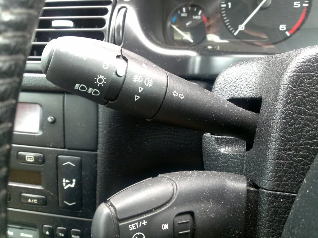

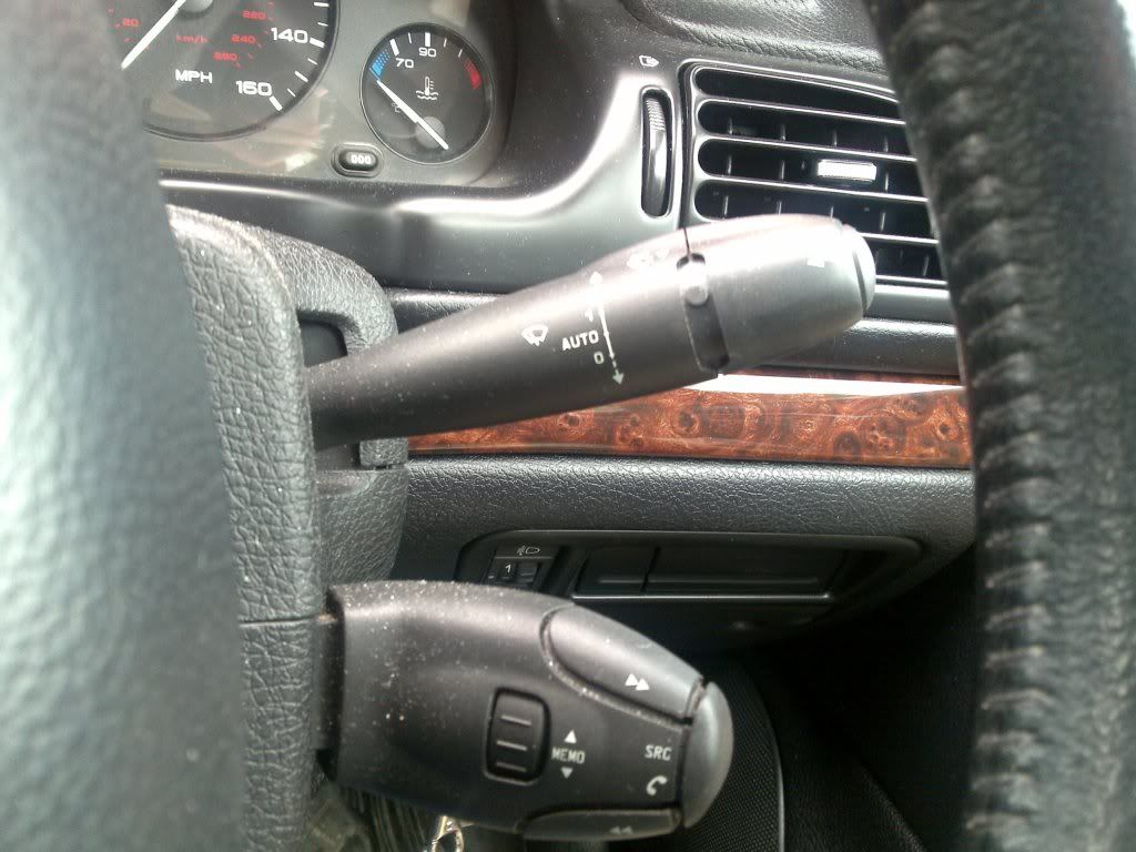

If your car is Multiplexed, ie has the Com 2000 indicator and wiper stalks unit, then it'll be a straight swap.
Upload a picture of your indicator and wiper stalks and I'll tell you if your car is multiplexed or not.

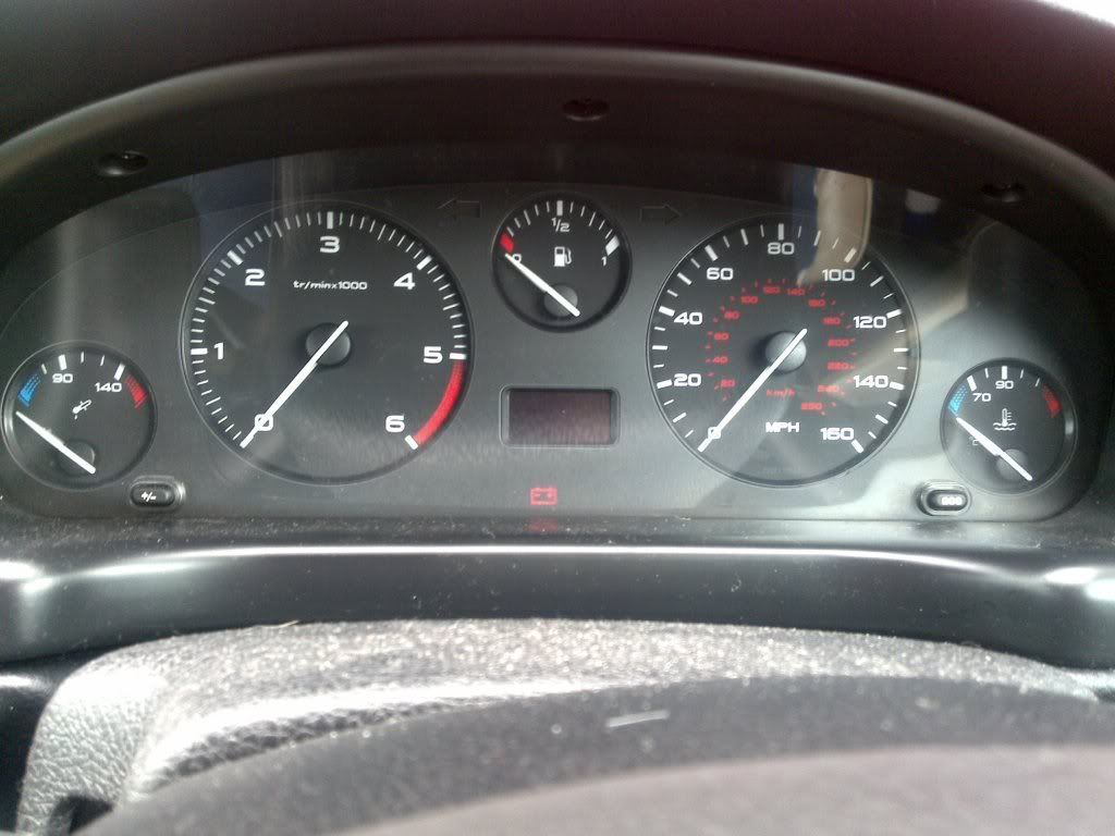

I am sure the car has a com 2000 unit because when i bought it the indicator stalk had been broken, so i got a new one at £120 so i remembered the com2000 being a main part of the car, but heres pictures just to show the stalks and the current gagues:
would the white dials work ok here, and would the whole speedo unit have to be changed because that would cause problems with the milage displayed on the clock

Yup, thats Com 2000. So a white dash set will simply plug in and go.
The mileafe reading will be whatever the dashboard clocks last read (if second hand).
