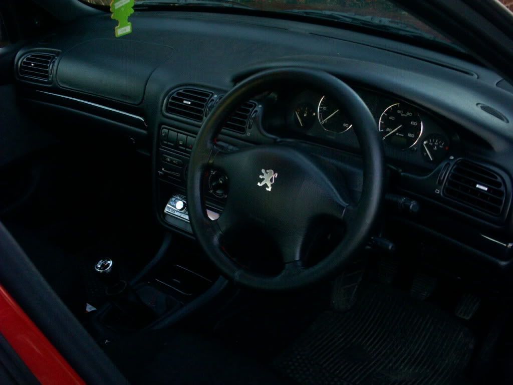

me and dave (plod) have done this. its not easy. it takes time and effort BUT i found the chrome surround for the fuel and temp dial catched on the dial itself and wouldnt allow it to move.
heres a pic of mine , to be honest i wouldnt bother trying this because you will probably find out the same as me, the fuel and temp ones wont work cos they touch the dials.

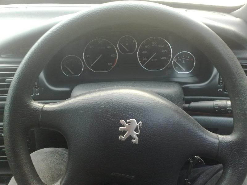

altho dave (plod) succeded in all chrome dials. (see 2nd pic)
these are daves (plod) all of which work fine

I guess they are expensive for what they are, but it don't half freshen it up, and because of that, I think they are worth it
They were a tad loose, and I mean only a tad loose, so I made sure that the bottom half of each ring was secured first, before working around the rest
I don't know if Gary did his differently and hence had a problem, but doing it my way, I have had no issues
