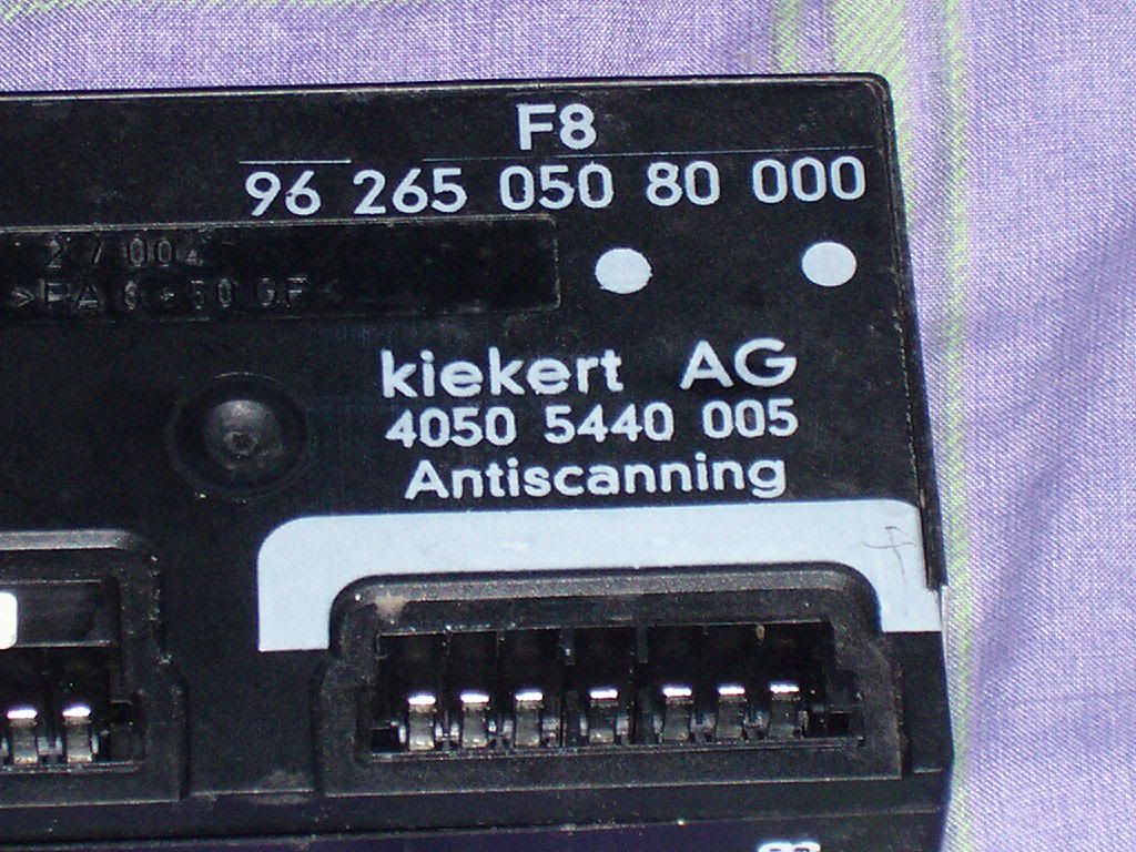

Okies, I pulled the cover and snapped the assorted ECUs. For clarity, could y'all have a peek at the attached photo and tell me which one is responsible for receiving the signal from my bleeper? Cheers.
