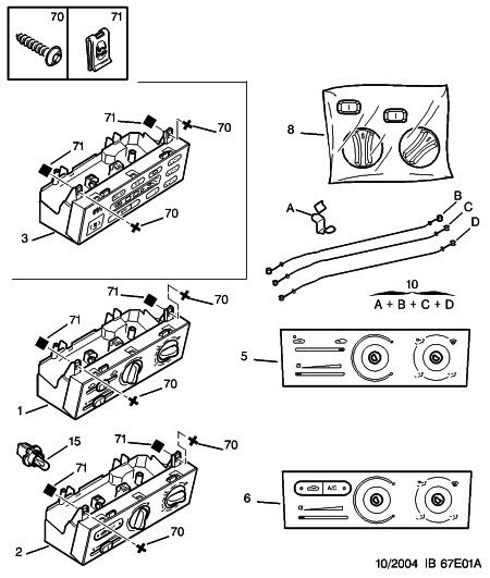

My bro's D8 has the same problem with the a/c & recirc not lighting up - think it could be down to lamp/holder 15 below:
15= 0000611260 BULB-HOLDER £2.75 inc vat
0000611256 BULB-HOLDER £2.02 inc vat, (some of them you can just change the bulb for about 50p, others seem to be soldered into the holders).mandelbug wrote:How much was the replacement clock bulb

with regards to the air con bulb my system is like the top one climate control is there a link to a post on how to remove this thanks to all who have posted as cant see a way other than trying to prize it out sure that cant be right
- Site Admin & Mad Biker!
- Posts: 6277
- Location: Woking, Surrey
Re: new 406 0wner needs help
Remove blanking plate to left of rear heated windows switch and remove screw, remove trip computer (or tray depending on trim level) and remove screw.skyman wrote:with regards to the air con bulb my system is like the top one climate control is there a link to a post on how to remove this thanks to all who have posted as cant see a way other than trying to prize it out sure that cant be right
Pull radio out and you'll see another two torx screws behind it on either side securing the climate control unit.
With these removed you can pull it out and get to the bulbs

On my pug I have the upper climate display, but only the left hand side is illuminated (during the day). I've checked in my Haynes, but cannot find any mention of bulb replacement. So is the display self illunimating, in which case the right-hand side is not working, or is there a buld replacement option?

Yes there are bulbs; remove the CC unit and you'll be able to swap them outLostBloke wrote:Hi
