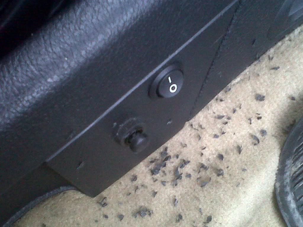

At this stage you need a switch, because at some point you may not wish to have footwell lights turned on, so mount it somewhere your happy with, i mouted my SPST (single pole single throw) rocker switch into the side of the centre console, hidden by the seat when in my position, this one takes a 21mm hole:
(ignore the second push button a mistake i made once)
So at the back of a standard SPST switch there is 2 terminals, and as you know when the switch is at I they are both connected, so now get another bit of wire, put the crimp connectors on to connect it to the switch and thread it up under the gear change gatier, under the ash tray, under the radio, into the passenger footwell, again using cable ties to keep it tight. At this point if you want you can just use the switch to manually turn on and off the power supply going to the footwell lights but where is the excitment in that, and they are not as useful then. Before getting the right circuit i had this setup for a while and its not really very useful.
Also its worth noting that it would be a good time to add a DPDT (Double pole double throw) switch now if you wanted instead of the SPST this would mean that you could have the footwell lights in 3 modes
- permantly off
- on
- on in tandem with the courtesy light
A DPDT switch really then only has the advantage of still letting you turn on the footwell lights independantly of the courtesy light, i didnt see it necessary as you can simply turn on the courtesy light as normal to activate the footwell lights when the circuit is finished, but its worth noting this now.

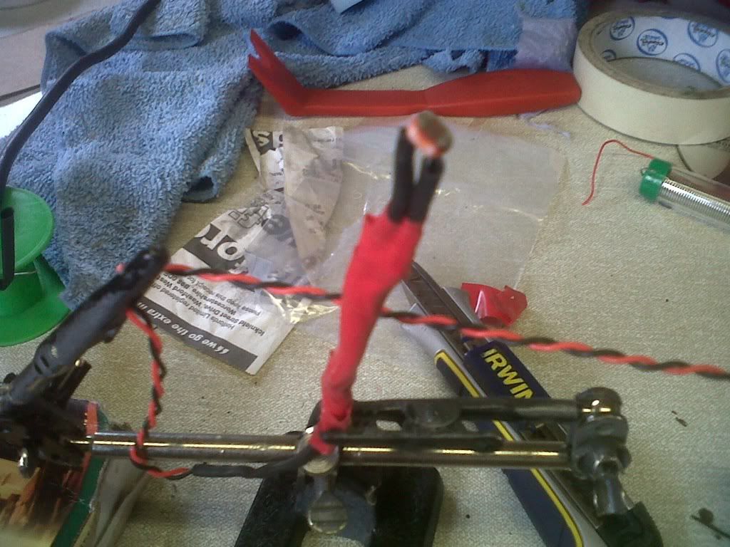

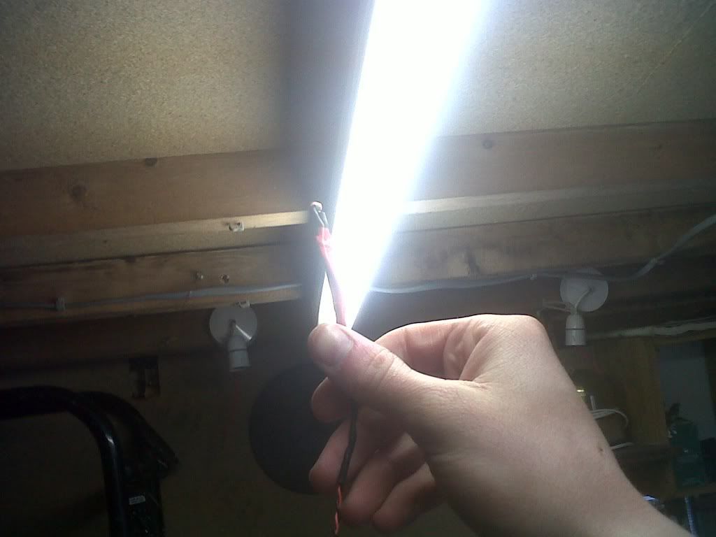

Now then the last external thing the circuit needs is an LDR, a Light dependant resistor, solder its legs onto a long strand of wire, colours dont really matter as LDRs dont have a politary. Anyway the wires need to be long enough to get from the overhead courtesy light down into the footwell, that means going past the sun visors, down the a pillar down through the dash (threading it down is easy just open that flap at the side of the dash and its a doddle) so cut the right length of wire.
So here is an LDR soldered to the wires, make sure both wires dont touch or the thing would short and not work:

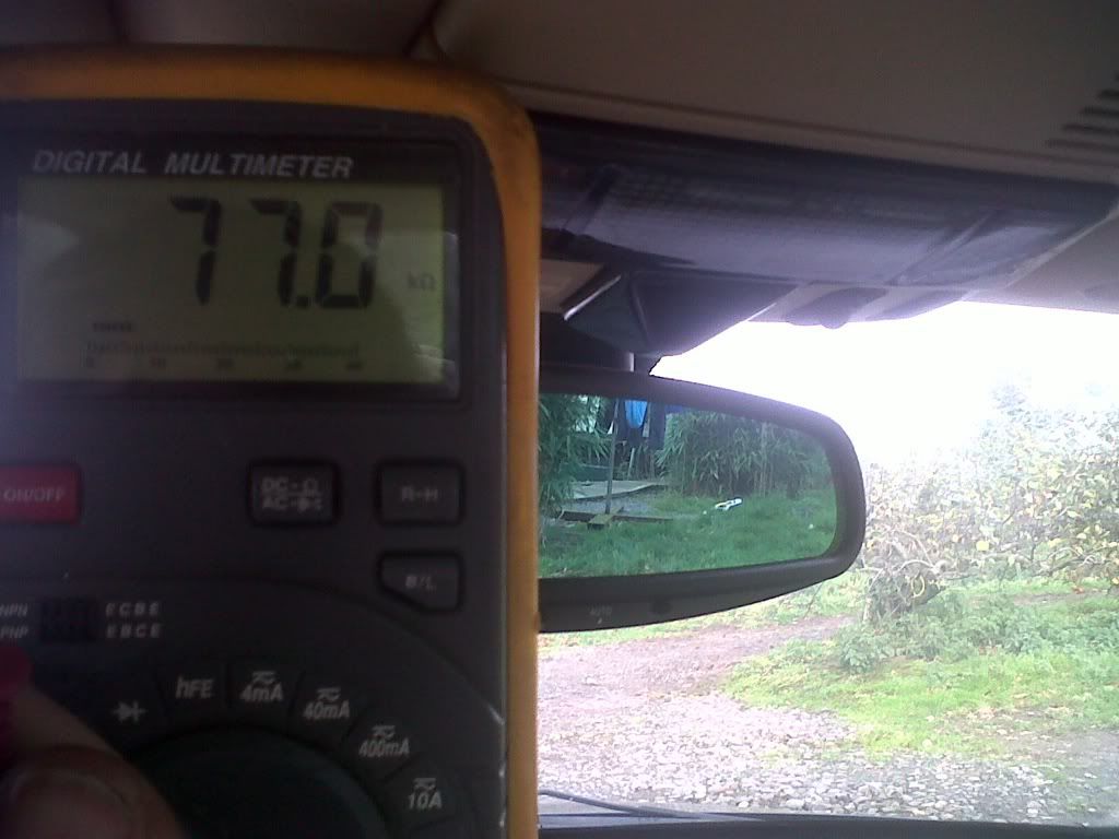

this is now a good time to connect a resistance meter, and check how the resistance of the LDR changes in the light and dark, its nice to see, but also confirms you didnt wreck the LDR when soldering it:

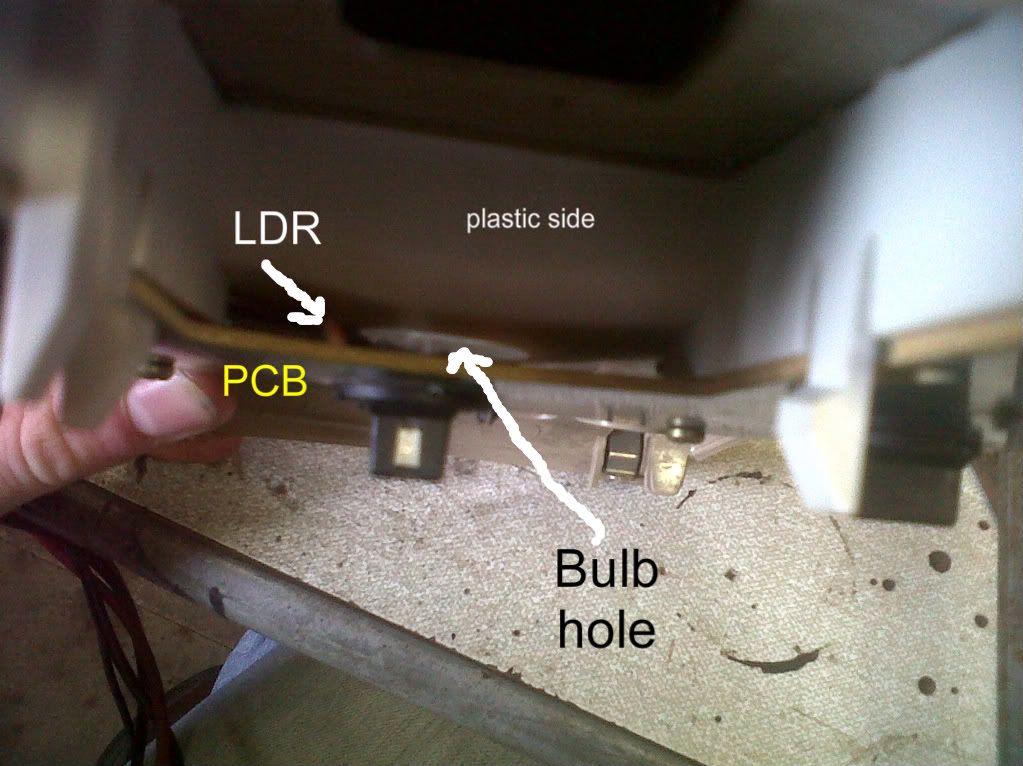

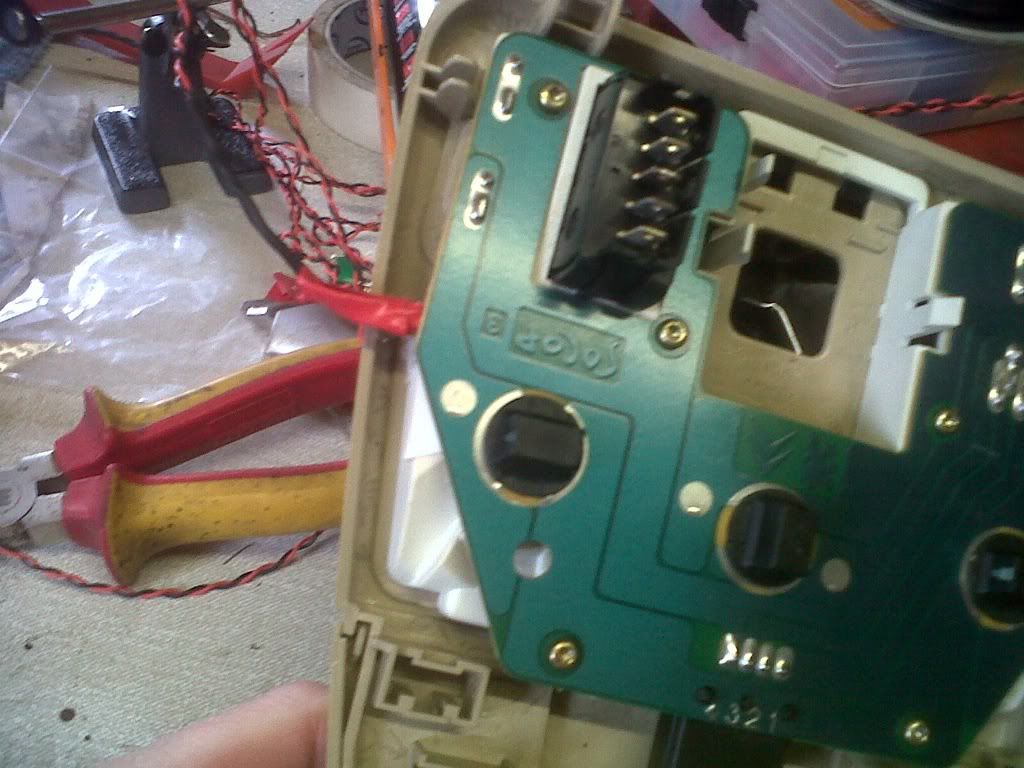

now then pull out the courtesy light, fully take it out of the car and into a shed or workplace, take the PCB bit of it off the plastic bit, the middle light is the one that we are after it gets turned on when the doors open, unlock, lock or when the key is removed for the igniton ie the perfect times for the footwell lights to come on, so putting the LDR therefore beside it is the perfect place. Mount the LDR about 3mm back off the hole for the bulb, on the plastic side, put a dab of adhesive on behind the bit that senses the light. Then put the PCB on again, make sure the LDR is sitting on its side or else the PCB wont go back on, screw the PCB back on and it will clamp the LDR in there very good. This shows what ive just described:
this is the back of the courtesy light showing the screws that hold the PCB into place.

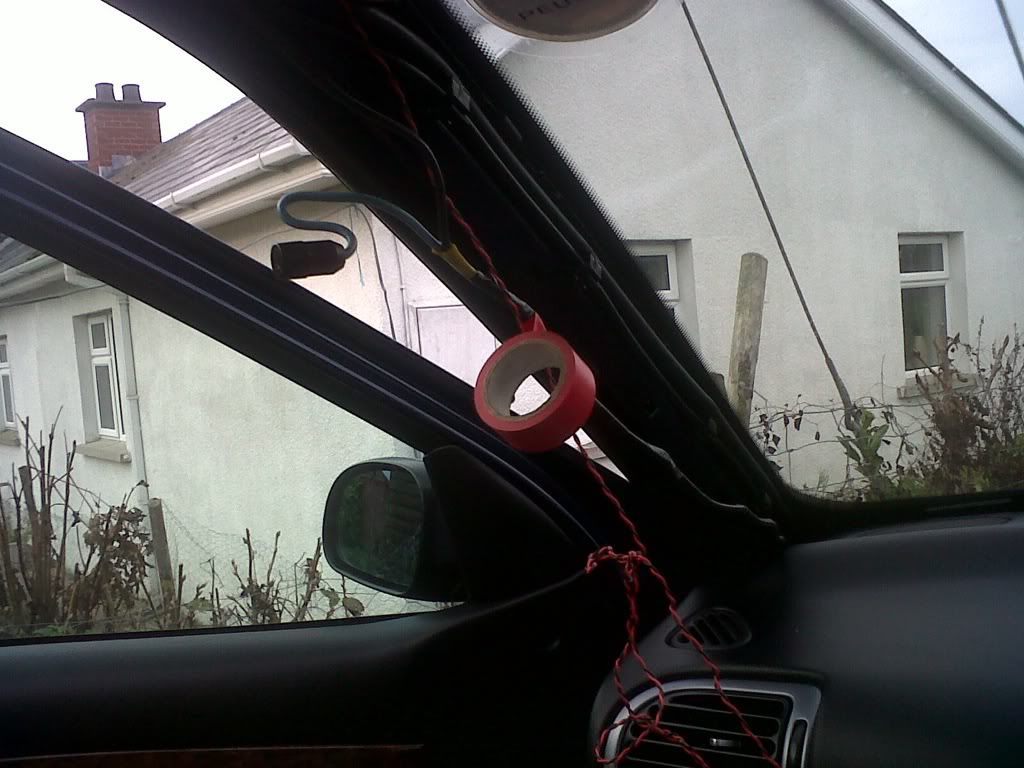

Thread the wire as described down into the footwell, this requires taking off the sun visor, and the A pillar, again make sure the wire is kept tight to stop rattles:

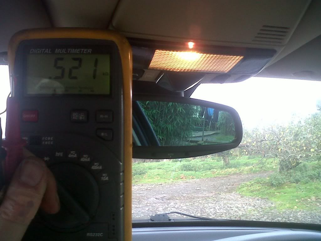

now confirm the LDR is working correctly, test the resistance with the light on:
and off:
an analogue resistance meter would illustrate it better but basically the resistance should be significantly lower with the light on than off, dont worry about ambient light leaking in, the courtesy light lens takes care of that, and if you mount the LDR back about 3mm it will stop it getting affected by backround light, even better the circuit which will be used can have its switch on level adjusted.

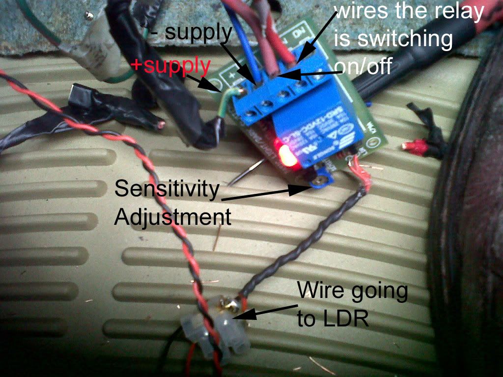

Now then you need to purchase the Light activated relay circuit to take the 12v from the battery and switch it on sending power to the footwell lights when the courtesy light comes on. I tried designing my own circuit and building it wasted £30 trying to get the components to find out it didnt work, i also bought a dusk activated device £20 pissed down the drain, which was too insensitive and slow to react, i then got the right circuit but buggered up the soldering £10 lost, so the circuit to get is this one in the already assembled form:
http://www.quasarelectronics.com/3079a- ... switch.htm

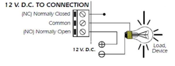

Wait for it to arrive, then wire it up, wiring it is very simple it needs a power supply obviously, put the negative straight into it, and put one wire from the switch you mounted to the centre console to the +ve, and the other wire from the switch going to the positive, on this circuit. Which gives the switch the switching power over the positive supply.
Then you need to think about how the footwell lights are to be wired up. Well they need to be switched, and its best to switch the positive supply, so wire up the negative supply directly to the negative, the same one used to feed the circuit, as for the positive, take the same positive supplying the circuit, and put it to the COM pin on the relay, then send the wire going to the positive of the footwell lights to the other pin of the relay. Ie like this diagram i got from the instructions:
overall it should look something like this:
the LDR on a pre assembled circuit may be already mounted, you could snip it off, and solder the wires to its original legs (would also require heat shrink, and some form of insulation tape).
Alternativley unsolder the LDR, and solder in the wires from the courtesy light LDR straight onto the PCB, but that can cause damage to the copper tracks and ruin the circuit, if your not careful, so its your choice.
And hopefully that should be it, tuck it away in any manner you like, between the right left hand side of the car, and fan motor there is ample room to mount it somewhere, make sure wherever its mounted its mounted tight or you will hear rattles, and cover the circuit in some way, be it insulating tape or a neat plastic box, because it could touch something metal or another wire in the car and cause a fire. As could any badly done bit of wiring, so make sure all the connections you do are very good, and well insulated, so probably doing it proper and getting a pcb mounting box like this is the better plan:
and off:
