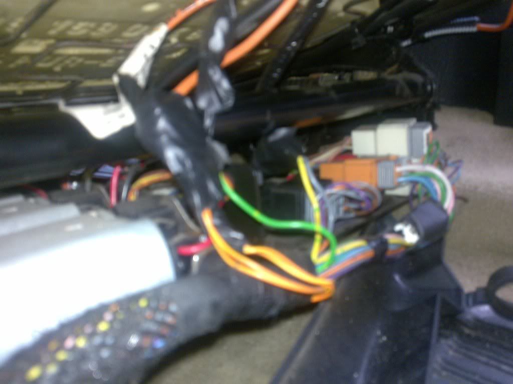

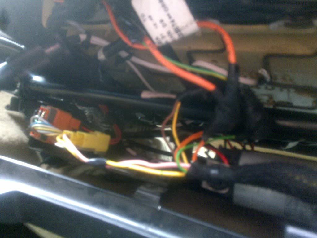

Heres the wires i have removed the connectors from basically all the ones not to do with the seat motors, some are terminal blocks, some soldered, then all insulated with black tape:
Drivers side
Passenger side

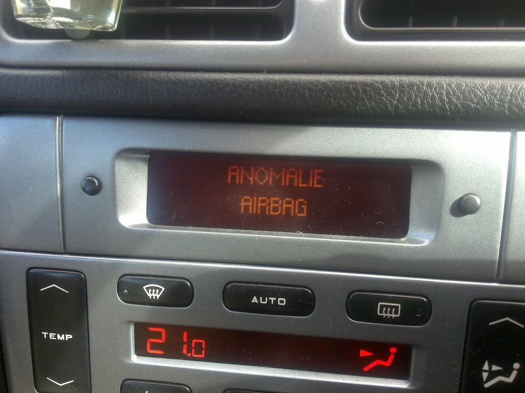

Then here is the airbag fault coming up on the MFD, you might say you have seen this, but its in french, i changed it to french everything looks much more interesting:
