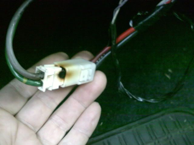

under the glovebox is the main connector for the power. i would check here 1st its common for the connector start to melt
its directly under the fan behind the glovebox ..
it will probably look like this or worse . it could be this or something else. but its worth checking here 1st as its easiest
and using some 30amp connector blocks is what mine looks like now

As Gary said that connector block is a common failure, I have a chunky household connector block in mine.
If you still have problems take a trip to the breakers for a replacement, the resistor fitted to the motor would be the other thing to die. I changed mine for a motor from a 3 litre V6, it fixed the heater fault but strangely didn't give me V6 performance
Motor removal is a doddle, undo the 3 screws to drop the motor from it's housing and pull the brown block from the motor - job done in 2 minutes
Here in the UK they're easy enough to find in breakers yards, I paid £10 for a replacement, no idea how easy they are to find in Oz?

ah thanks guys - ill check in the morning, everything else looked fine but didnt check on that side if the car, a new motor would probably be available but im 2000km away from a major city, so may have to ring around and get it shipped up if thats the case

ok - the connector looks great - no fail there

i had a similar problem and found it to be a controller box underneath the dash the size of a cigarette packet cost about 70 pound unless you can get a 2nd hand one
only a suggestion as i not a mechanic
hope it helps
