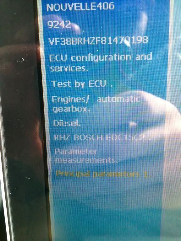

The cruise control, peugeot planet helps set up the brake pedal and clutch pedal switches just right, screenshots:
(one is not mine i forget who gave me the picture, but its for parameter measurement over the switches)

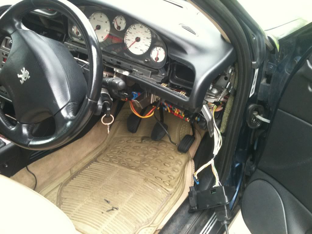

putting in or moving the switches isn't comfortable, so its easier to drop the steering column:

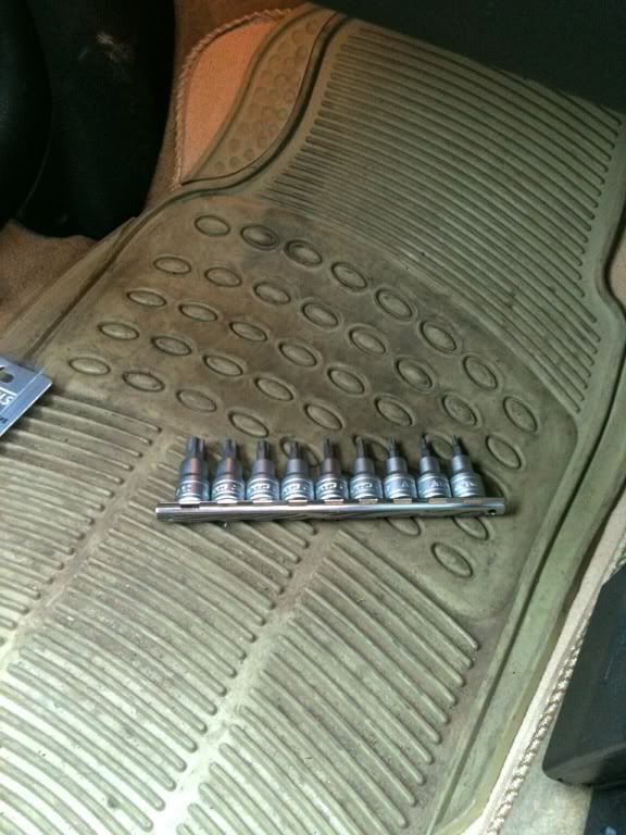

that requires the use of torx sockets, but its them security ones, the rail with the important sizes work out the best value:

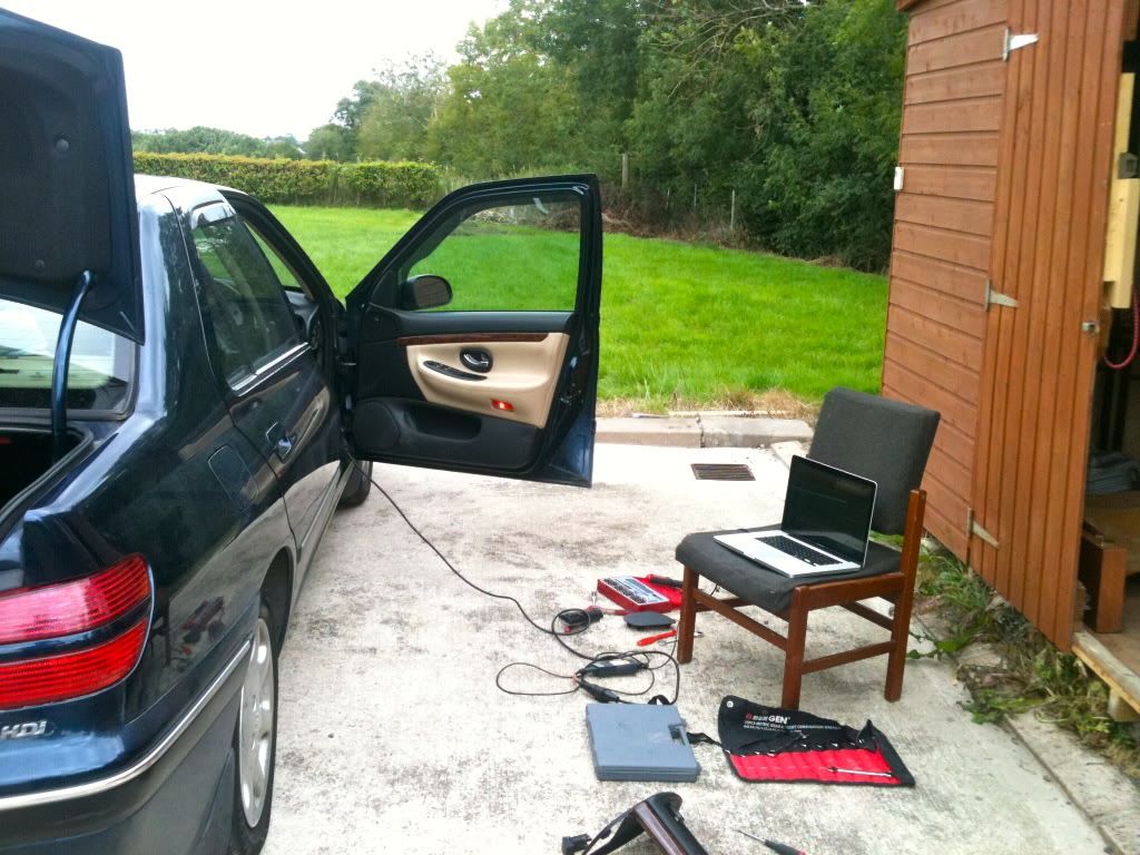

My that's spooky Frank - looks just like my prehistoric laptop you've got there!
Which came first in the bottom picture BTW?

Thats it doggy you gave me the picture a while back, i didn't want to say i couldn't remember if it was you or captain jack.Doggy wrote:My that's spooky Frank - looks just like my prehistoric laptop you've got there!![]()
Sorry about the picture i clicked on the wrong link it should have been this:
