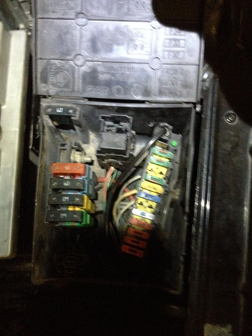

I got the car round today, it really has been butchered at.
There are parts round behind the ecu and the wiring going to it, there was chafed wiring, burnt insulation and a relay box dangling down. So i took out the battery, quickly tidied at the wiring but no change.
The in tank pump has a bit of diy wiring going on, a wire runs from the fuse box, under the carpet, and up to the pump, so once the ignition is on the pump comes on and stays on with the ignition:
This relay in the engine bay is making a clicking noise when the engine is on:

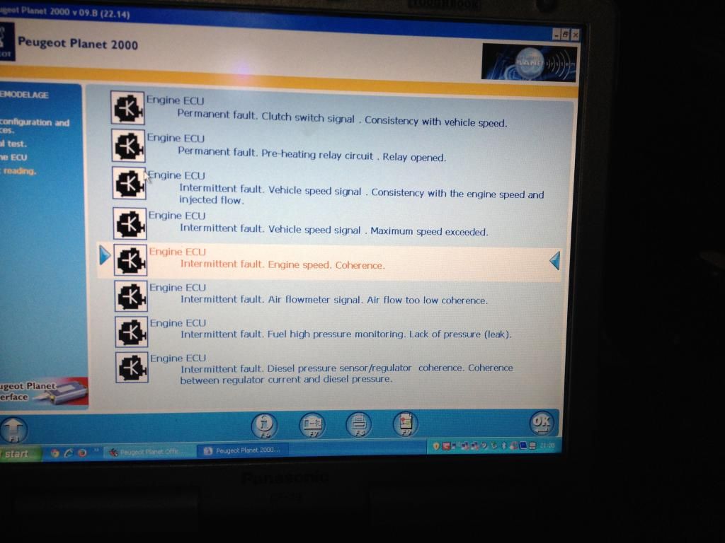

And these are the faults it showed up:
and this
I still have the spare HDI engine sitting about, with all its sensors, so far i have changed the cam sensor but its stayed the same, what faults should i pay attention here, is the pressure regulator sensor worth changing?
and this
Re: random non start issue
That is a right flipping mess, the last fault "Key Faulty" intermittent is a pain because it looks as though sometimes the car won't recognise its own key and immobilises itself?
By the sounds of this car there could be a short in the wiring somewhere, question is: Where?
