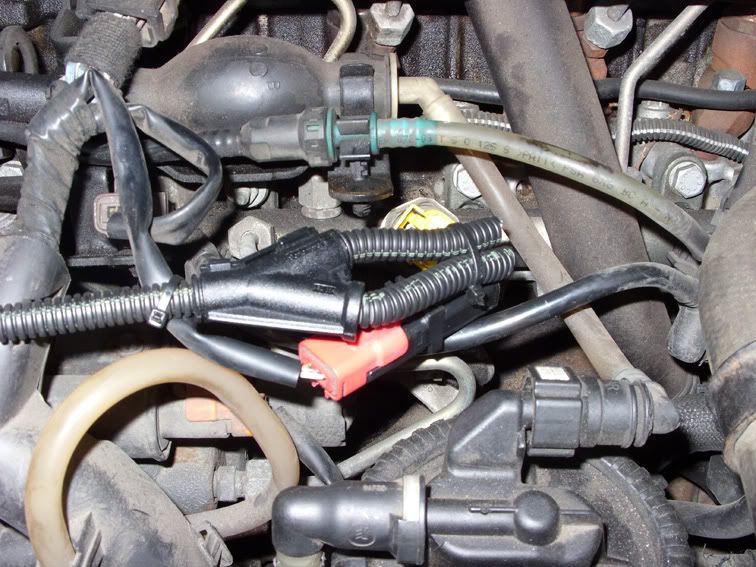

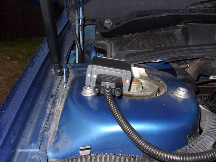

Here you go - you basically have to remove one plug and plug the box in the put the original plug into the box and that is basically it I ran the cable round the box that houses the ECU as there is plenty of room in there and its nice and hidden away ( I took it out to take the piccy)
