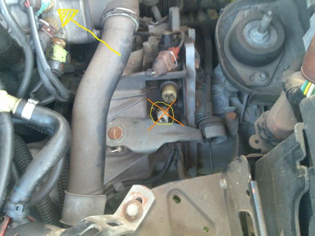

After having a look i found and disconnected the coolant sensor and everything is back to normall!
A replacement is on its way, (the only one in Australia!).
Thanx a million for the advice!
The attached photo is where i found the coolant temperature sensor:

Re: Faulty temp sensor?
After the sensor arrived i tried to install but it didnt fit
But.... found the hole it DID fit in:
That white one that i unplugged turned out 2 be the reverse light switch.
Im still puzzled why it fixed the problem when i unplugged it though????
Anyway all is now good!
I suspect you may have moved/knocked whatever was actually causing the fault - as far as I'm aware the reverse gear switch on D8s is wired straight to the reverse lights (maybe via a relay...)BJ92 wrote:Im still puzzled why it fixed the problem when i unplugged it though????![]()
Anyone know what that unrestrained connector just above it is for?
